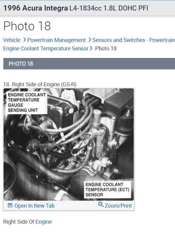

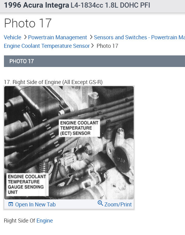

The engine coolant sensor is near the distributor here is a guide that will walk you through the steps with diagrams below to show you on your car.
https://www.2carpros.com/articles/coolant-temperature-sensor-cts-replacement

Well, I feel like an ass. I was getting my voltage reading from the temperature sensor that is more towards the intake manifold. the one directly below the distributor does have the correct voltage of 5V. I pulled the back up and ecm fuses and waited 10 seconds before putting them back in and the check engine light went off but came right back on within 2 seconds of the engine running.
