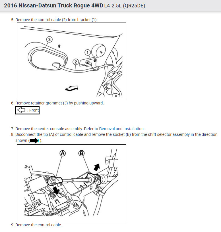

When I press on the gas pedal, my acceleration isn't matching my RPMs. It takes awhile to get to 60 MPH even though my RPMs are above 2.5. There is no dashboard lighting.

You might be having an issue with the CVT transmission.
Does this only happen when the outside temperature it hot and the vehicle has been running for a while?
There is a known issue for these vehicles, that that a transmission module limits power when it reaches certain temperature.
Let me know little bit more information.

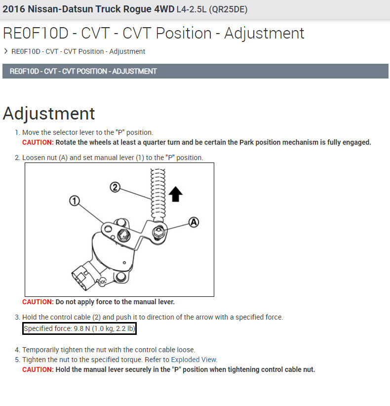

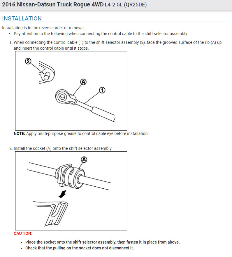

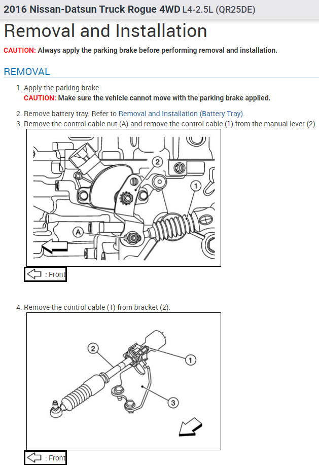

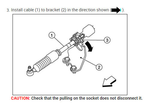

This could be an issue with the CVT control cable or the control module.
The tricky part is that the vehicle is not showing any error codes (warning lights).
Nissan did have some recall for these CVT transmissions.
Do you know if that recall was performed?
If you are not sure just call your local dealer and provide them with the VIN and they can let you know.
