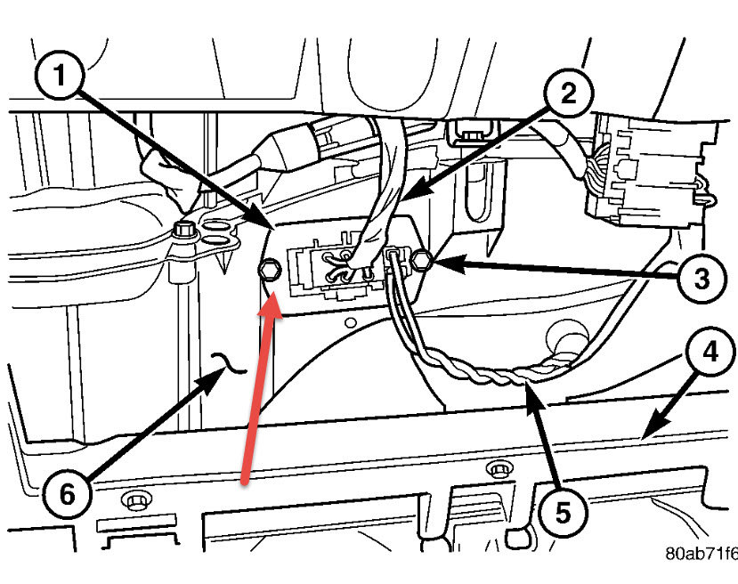

A/C isn't blowing any cool air when you first get in vehicle and start it up & your driving down the highway. I've drove about two miles & it starts to blow cool air. It only blows one speed & it's low, it doesn't matter if you turn the fan speed dial all the way up too high, its still just blowing low speed. If I engage the recirculate switch, you can feel the motor pull down but the cool air that was coming out isn't coming out anymore until you disengage the recirculate switch. When I shut off the van & go into a store & then get back into van & start it up again to leave, it starts all over again. I have too drive 2 miles or so before it blows out cool air again. Help me; Please it's getting HOT in Arkansas!! Thanks for any info, will be greatly appreciated

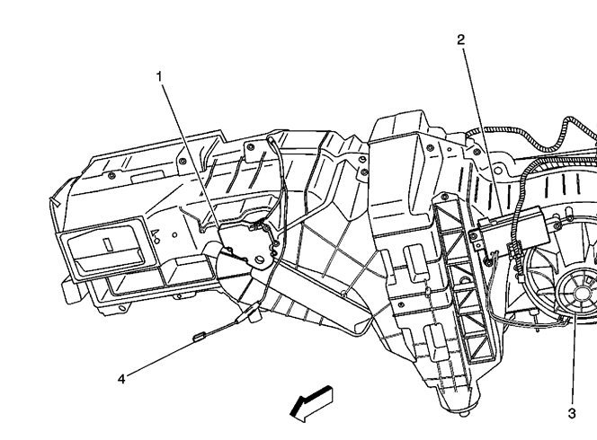

try pulling hvac fuse inside car for 60 seconds with key on it may reset actuators. then check to see if your blower resistor is good it may be the speed problem. arrow points to resistor in pic. if resistor is ok then have a mechanic scan for codes as it may be the blower motor module for speed causing problem as well.

Thank you HMAC300 For your info. The mechanic replaced the blower motor resistor connector & AC Is working just fine. Freezing me out!!!

try pulling hvac fuse inside car it may reset the actuators if it has dual zone meaning you can control each side for ac it' s item 6 if single zone the it's item 4 in pic these are on drivers side and apanel must be removed to access. if you set the temperature like at 72 degrees then it's auto temp control and a mechanic must scan for codes to see what is happening.

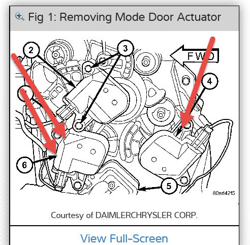

my 2005 town and country blows cold aie and heat sometimes. what could it be?
Sep 11, 2020 at 3:47 PM (Merged)
HMAC300
  • CAR REPAIR CONTRIBUTOR
  • 48,601 POSTS
it could be an actuator not working or getting stuck. you need to check fo see if it's vacuum or electric. generic pic included.
