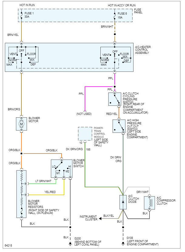

I need to wire in a trinary switch to my A/C for electric fans. I have Ford factory electrical manual, it shows a R/Y and P coming from cycling switch. I have a B/Y and P (this is factory). Is the B/Y going to be the same as the R/Y in the manual ???

It should be though I show the R/Y as well, here are the A/C wiring diagrams to help you complete the task. Check out the images (below). Please let us know if you need anything else to get the problem fixed.
