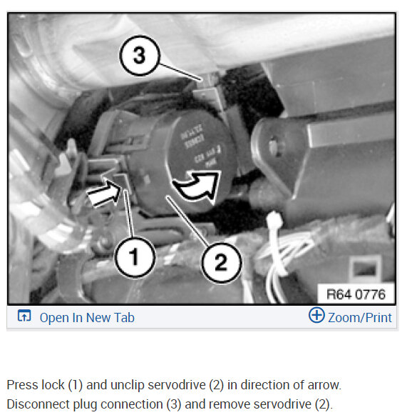

A/C do not work on the driver's side. blows hot air. The passenger side blows cold air. I do not know where the door actuator is located. can you please help?
Jun 16, 2024 at 8:13 AM
  • CAR REPAIR CONTRIBUTOR
  • 54,199 POSTS

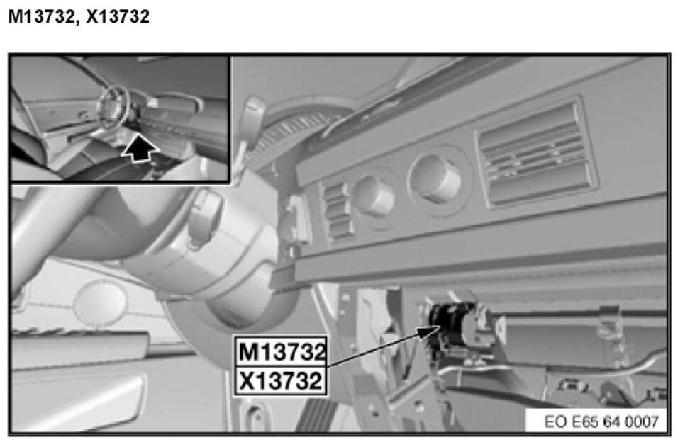

They call it a cold are flap, it is on the driver's side down low near the gas pedal. Check out the images (below). Please upload pictures or videos in your response to any problems so we can see what to help you with.
Jun 16, 2024 at 1:02 PM
MR.DRAE
Sorry, I don't understand the picture. It looks like it's by the console on that pic. I will send a pic. Hope you can help me.

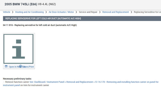

Here is more information on how to change the left side cold servo motor control. Check out the images (below). Let us know what you find.
