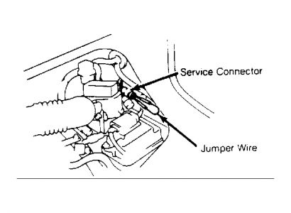

Near battery find i believe green connector jumper between T - E1 see diagram
Key in ON position DO NOT START when jumped MIL on dash will flash so flash, flash pause flash = 21
Post code numbers will advise
