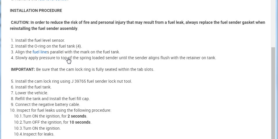

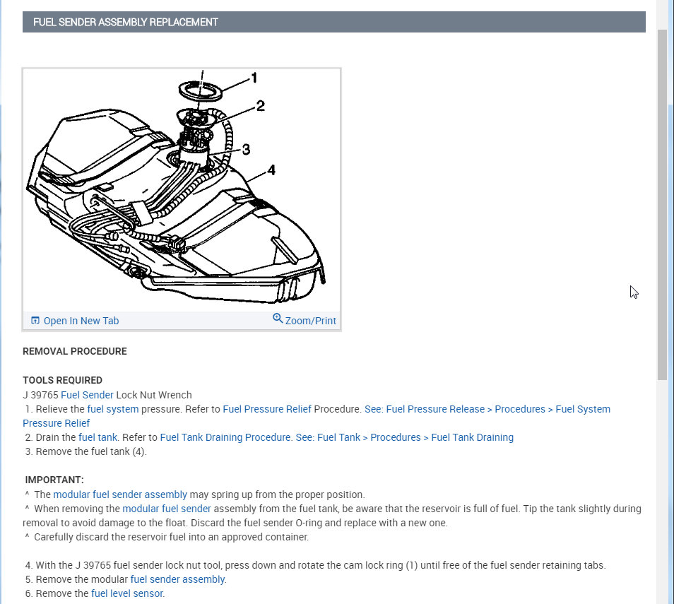

i been having stalling issues with my car listed above with a v6 3.4. my car will randomly stall out and will idle all out of wack if it sits at a light too long. the check engine light is on. had a random misfire code. i did a full tune up, oil change, fuel filter, plugs, wires, cleaned the throttle body, air filter. the fuel pressure had been tested in the car it is reading 46. the fuel pressure regulator has been replaced. also the IAC sensor, check all vacuum lines they are fine. i am at a total loss. please help.
Apr 11, 2020 at 4:23 PM (Merged)
CADIEMAN
  • CAR REPAIR CONTRIBUTOR
  • 3,544 POSTS
you will need to check the fuel pressure when the car stalls.
OLDMOBILE12
i have, it's run a 46. it's really low.
The fuel pressure is low and I suspect that is the cause of the stall and the multi cylinder misfire. Low pressure will cause the injectors to not fire properly and under deliver the needed amount of fuel. This will cause the cylinders to misfire randomly causing the multi cylinder misfire.
I attached the process to replace the fuel pump as I would go ahead and do this and retest the system.
Please let me know if there are questions. Thanks
