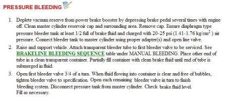

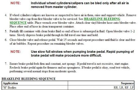

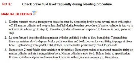

Step by step procedure for bleeding brakes.
