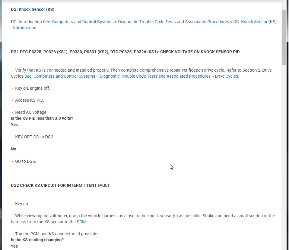

My car has I PO301 and a PO325. The misfire is random. I am looking for testing procedures. I am going to swap injectors to see if I can move the problem, but I am not sure how to test the coil. Does this car have a waste spark system so I can swap wire locations.(it does not have COP'S)
I am also trying to find the test procedure for the knock sensor. I have checked for resistance. there was no reading.. open circuit.

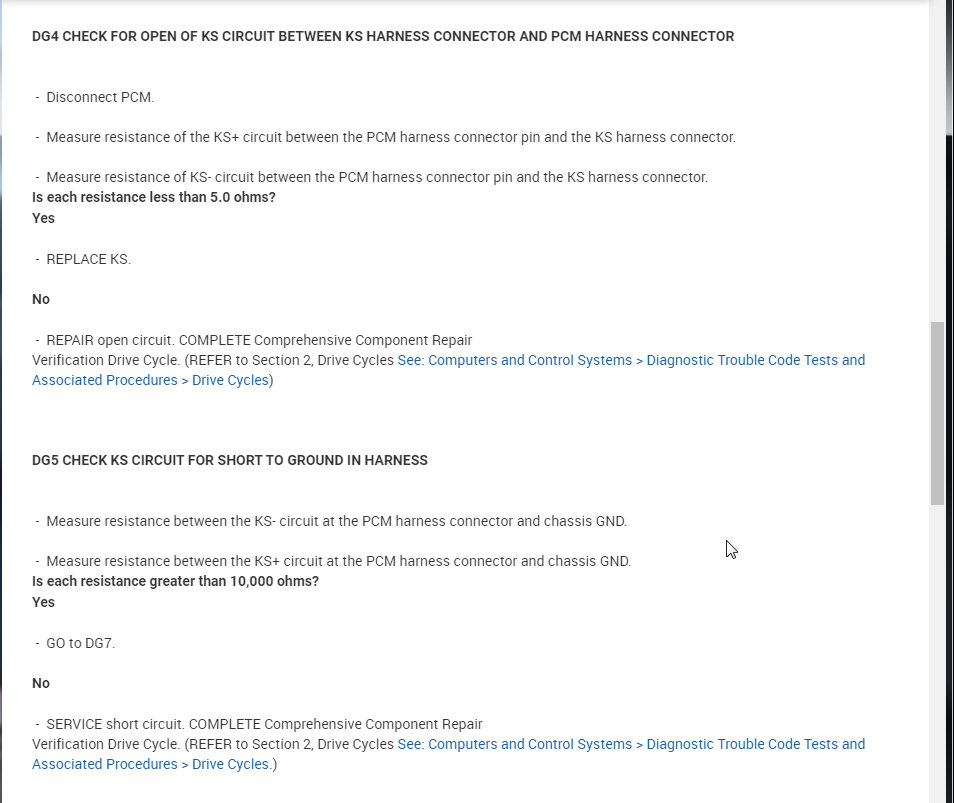

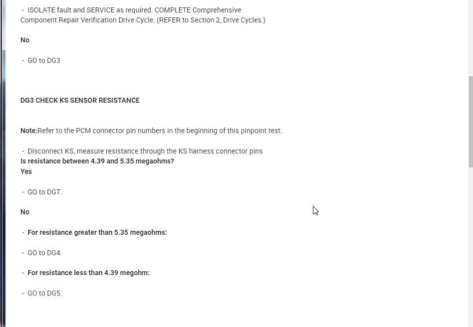

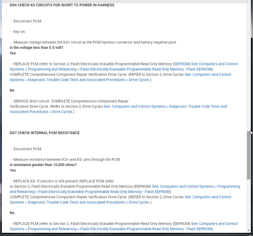

  • CAR REPAIR CONTRIBUTOR
So you checked resistance across the sensor itself? If you have an open circuit here then I would replace the sensor and retest the misfire because a faulty knock sensor can cause an intermittent misfire.
I attached the testing for this knock sensor code as well however, I suspect you won't get past step 4. They have you testing the circuit from the PCM but if you checked the sensor and it is open then I suspect that is the reason for this code.
Let me know if you have questions. Thanks

DAVEMALLARY
  • 14 POSTS
Yes, I checked resistance across the sensor itself, and it is open. I can't find the Knock sensor pid on my scanner.. I have an Autel 708. I don't really know how to use it, I bought it for educational purposes. I will get a new knock sensor and go from there.
