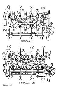

what do the head bolts torque to on a 2.5 engine

Tighten in 3 steps and follow torque sequence below.
step 1 is 17 - 19 Foot Lbs.
step 2 is additional 85 - 95 degrees
step 3 is additional 85 - 95 degrees
