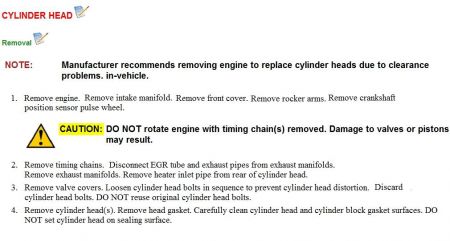

How do I replace the head gaskets on a 1997 Lincoln Continental?
Saturday, October 9th, 2010 AT 6:14 PM
BLUELIGHTNIN6
MECHANIC
16,542 POSTS
May want to leave this repair to a shop, engine must be removed..
