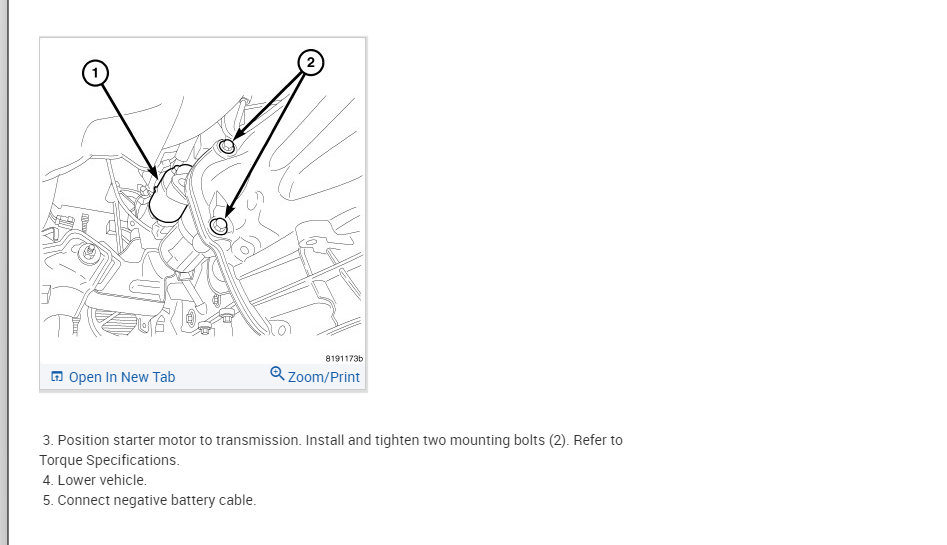

changing the starter on a 2009 Jeep Wrangler 4WD 3.8L SFI OHV 6cyl wanted to no if there was any tricks to do it because of the limited space with the drive shaft in the way and the exhaust 2 inches away
Aug 24, 2012 at 1:37 PM
  • CAR REPAIR CONTRIBUTOR

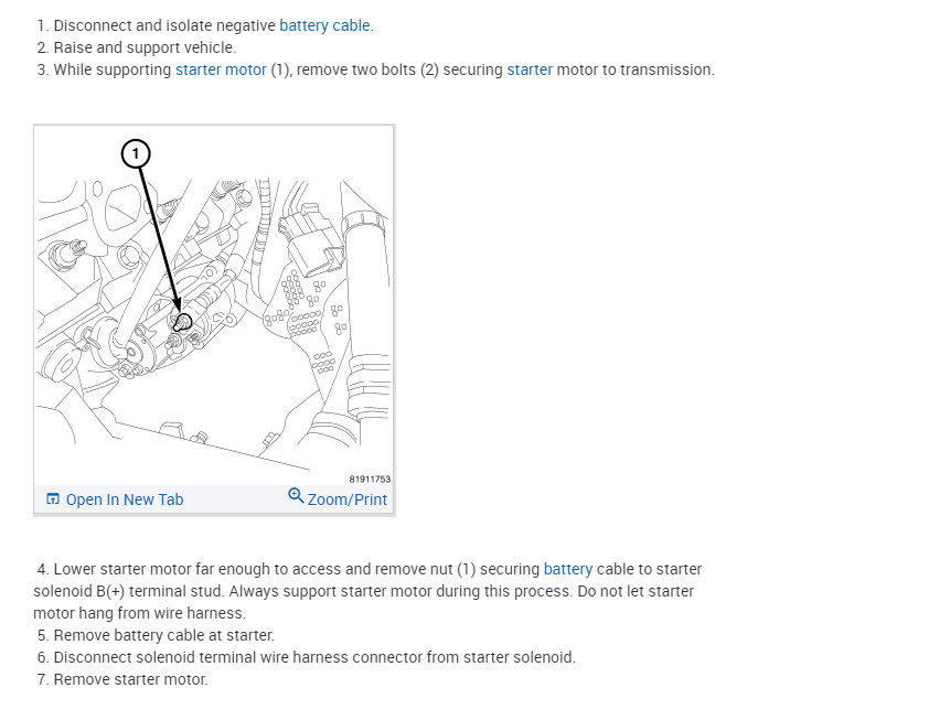

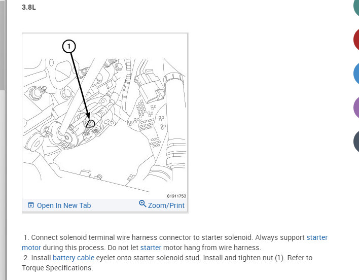

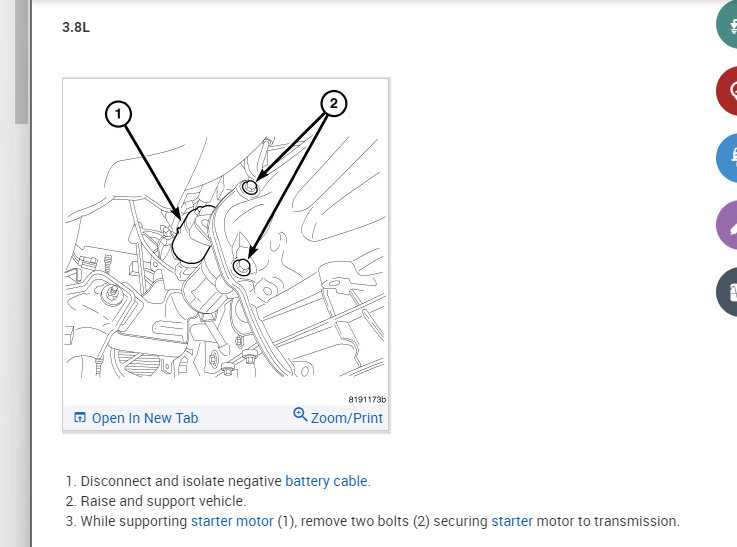

There are no tricks other than putting the vehicle on a lift so that you are able to get better access.
If there are no lifts available, then we need to use jack stands.
Here is a guide that will help with the starter replacement as there is good info in it:.
However, if you are not able to access it because of the drive shaft then I would just remove it.
Please see the info below on how to replace the starter from the manual.
Please run through this and let us know what questions you have. Thanks
