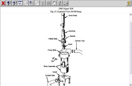

I have an 85 XJ6 and I need to know if the oil pump is internal or not.
Can anyone help?

Its inside-you have to remove the oil pan to get at it, also it looks like this.
