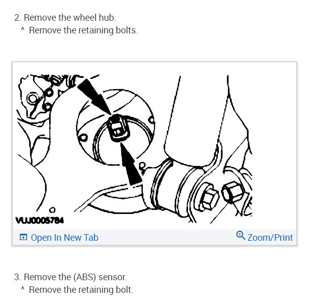

My abs lights are on. I am getting code B1165 - Could you please tell me what the possible causes are and what remedies I could try. I have already changed the abs sensor? OBD Codes coming up and I cannot find the meaning or how to correct them. Could you please help?

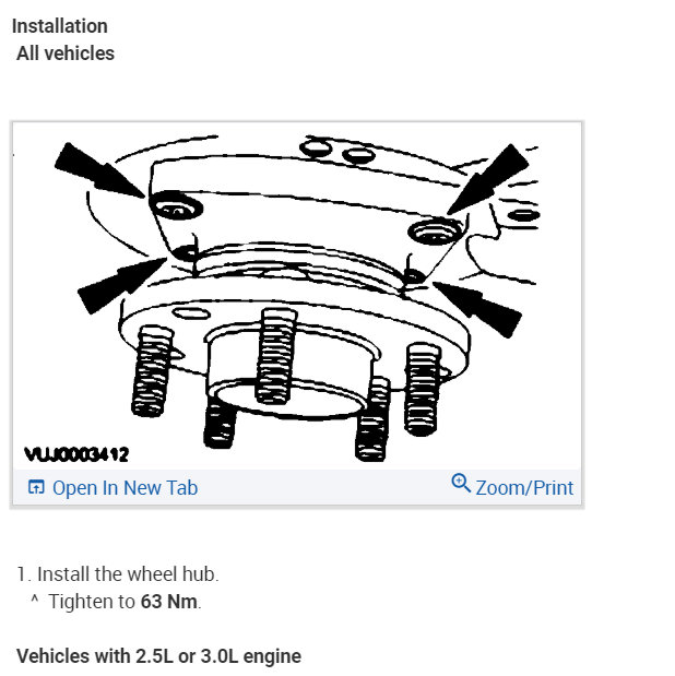

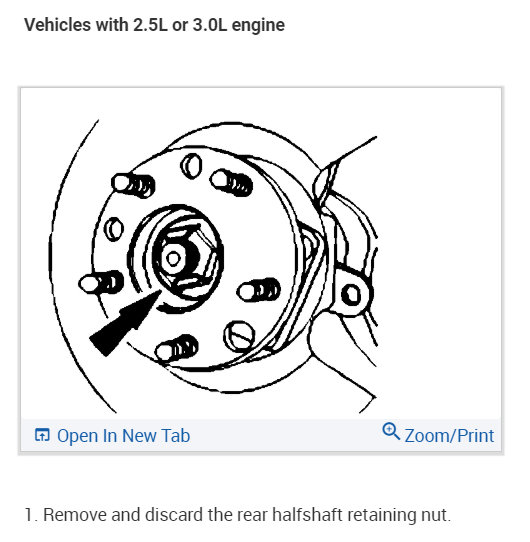

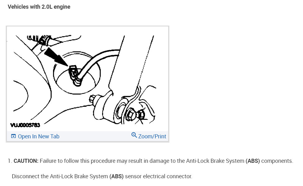

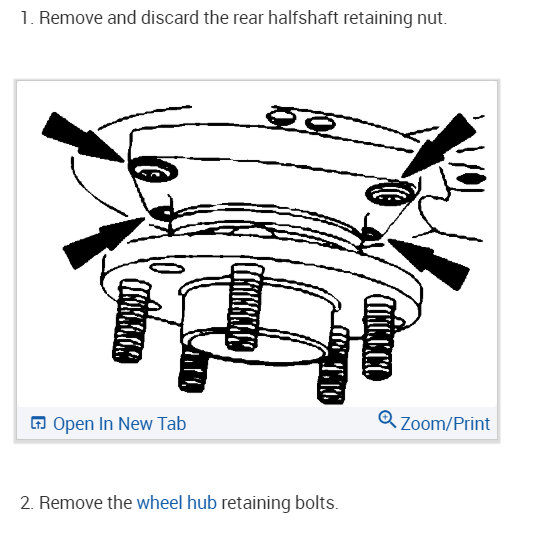

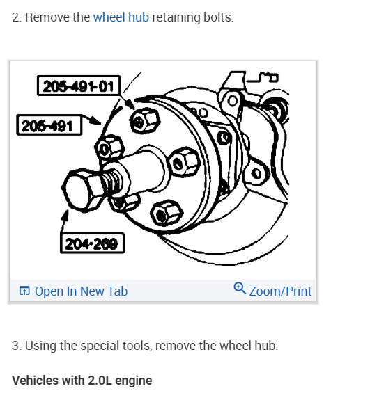

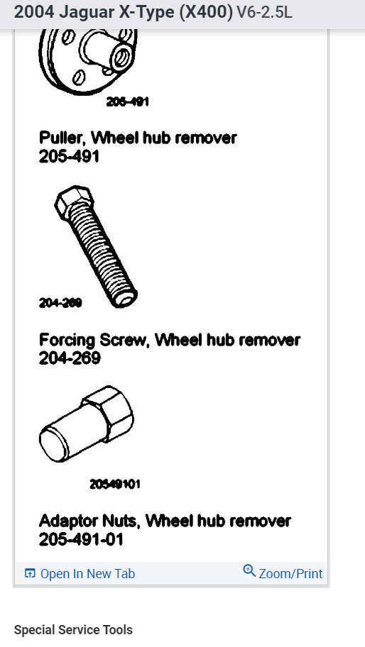

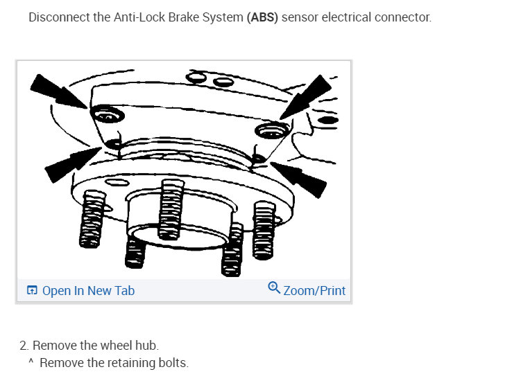

The problems can the the bearing which will cause the sensor to not work correctly. Here is a guide to help you check and replace the wheel bearings. Also recheck the sensor to make sure it is plugged in.
Jaguar: P1165 Rear right sensor - trigger monitoring
https://youtu.be/rTtAnsOlZU4
Tuesday, December 6th, 2011 AT 7:31 PM
ROCO58
  • 0 POST
Wow nice work I had this issue and the bearing hub fixed it cost me $178.00 did it myself :)
