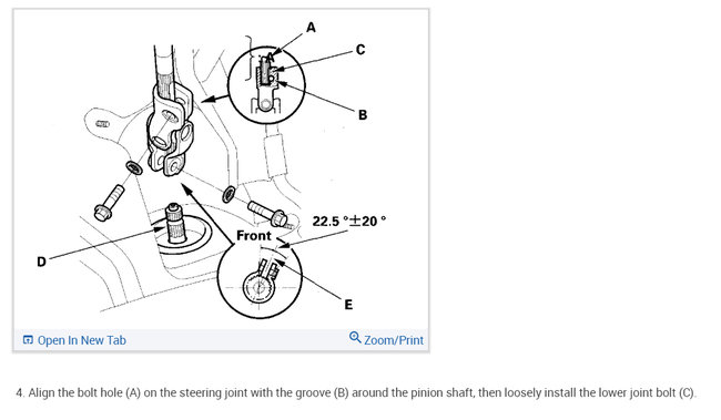

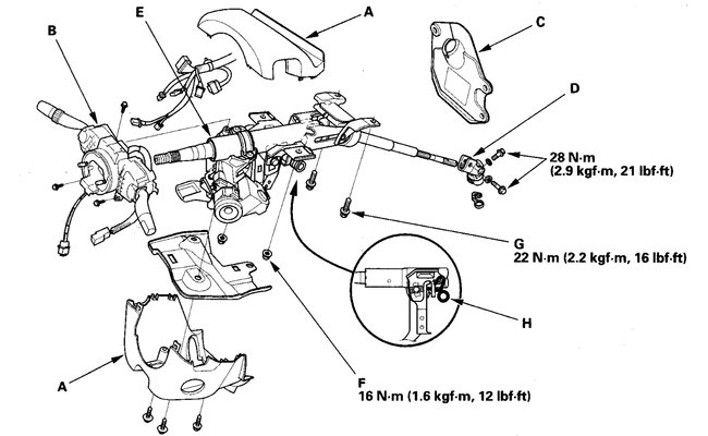

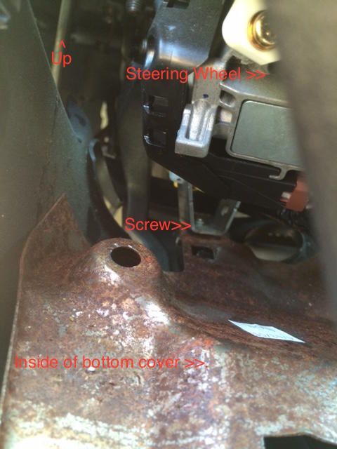

I need to remove the column cover. The top half is off and I've removed three phillips head screws that hold the bottom in place. However, it didn't just fall off. I've tugged, pushed and prodded. The sucker isn't moving. There seems to be one more screw that is obscured by the steering tilt lever. I can barely see it and I sure can't get to it. Any ideas? I need replace the ignition switch
I've attached an image that shows where the screw comes out.
Thanks.
Ellis

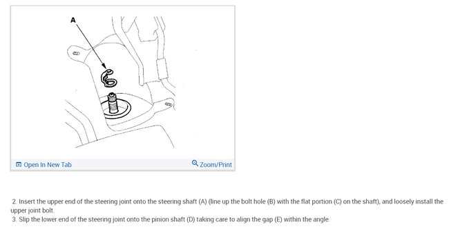

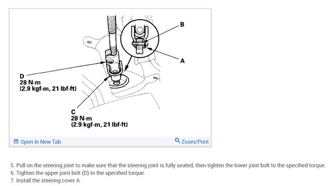

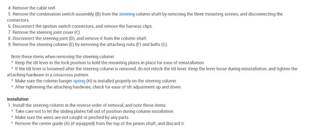

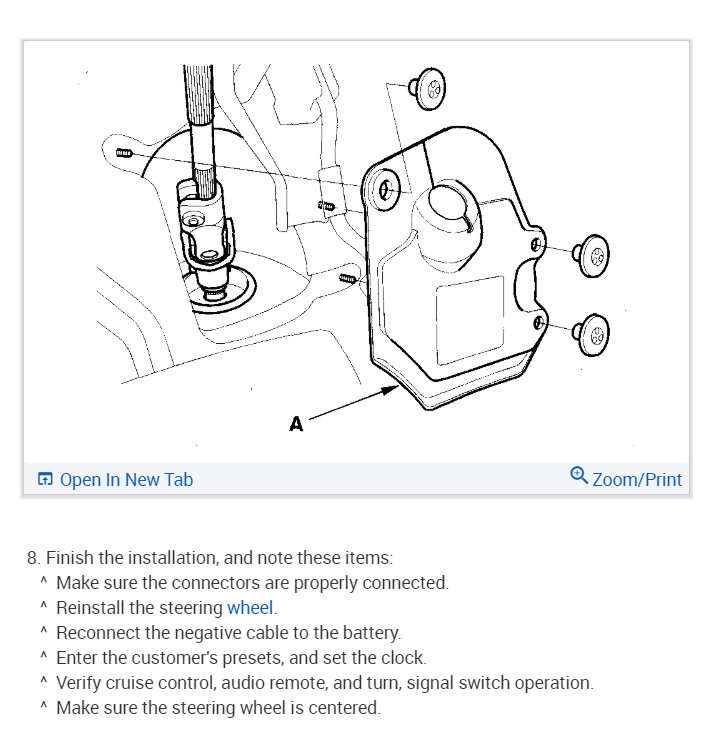

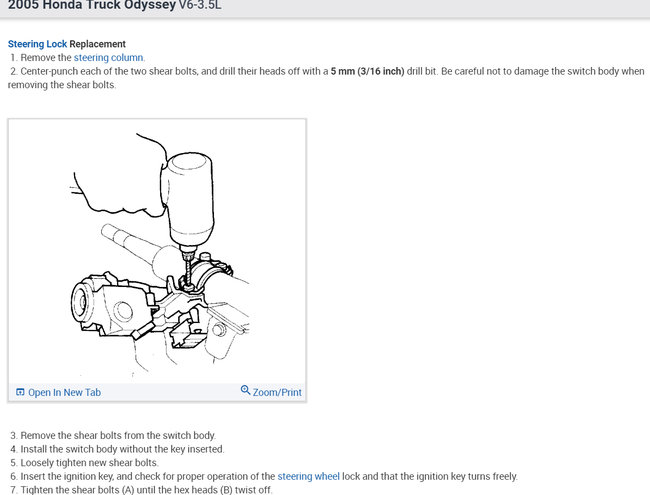

It looks like you will need to get to the underside of the screw that is where it comes undone I found these diagrams for you to help you remove the column and replace the ignition switch.

I can not remove the igintion harness from the steering column b/c the bolts are flat. How do I remove the ignition harness bolts/screws? 2003 Honda odyssey. The replacement screws have hex head tops. But the originals are smooth or flat.
Oct 16, 2018 at 12:55 PM (Merged)
DOCFIXIT
  • CAR REPAIR CONTRIBUTOR
  • 18,828 POSTS
Tamper proof bolts sometimes can get loose with Vise Grips otherwise center punch bolt drill off head
