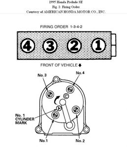

I just need a picture of a diagram for a 1995 honda prelude distributor cap wiring diagram, to figure out if thats my problem
Sunday, April 18th, 2010 AT 8:02 PM
KHLOW2008
MECHANIC
41,815 POSTS
Hi snowwolf858,
Hope my guess is correct and this is what you are looking for.
