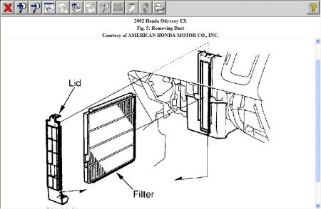

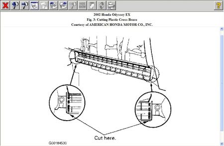

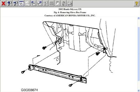

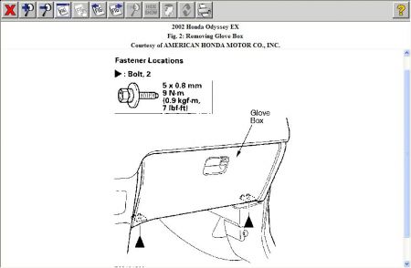

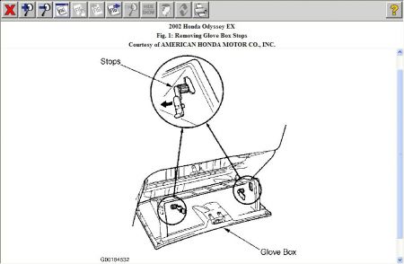

Hi honda03,
The following diagrams should be clear enough for you.
