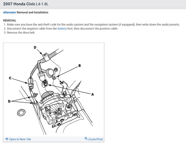

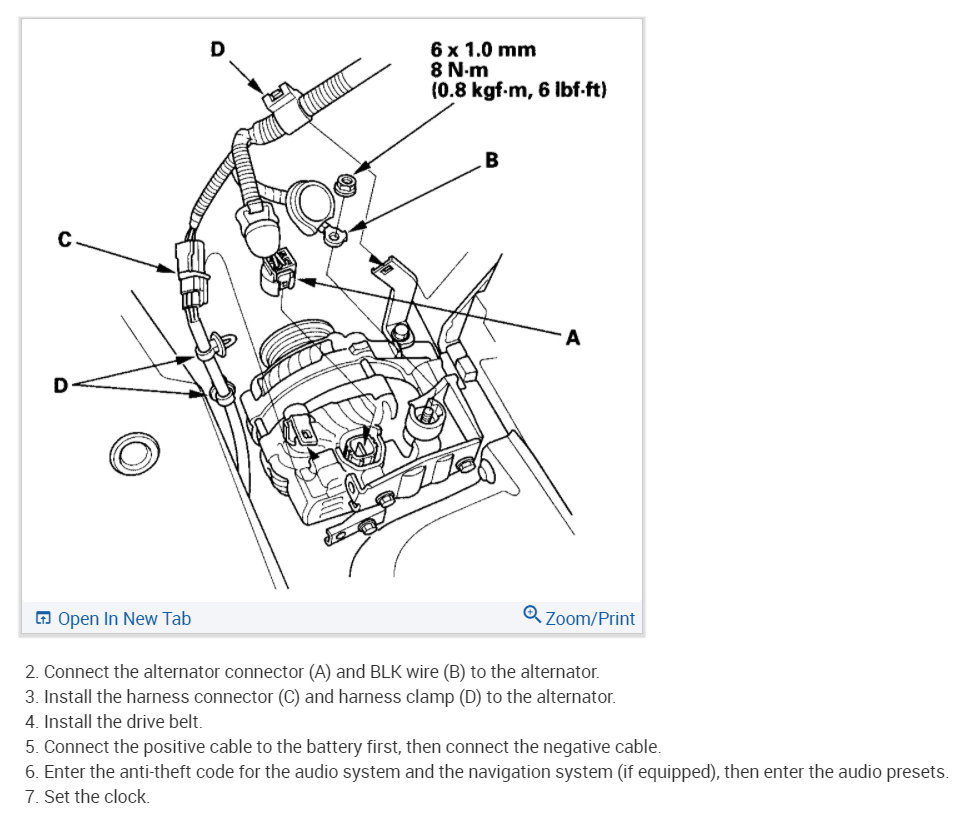

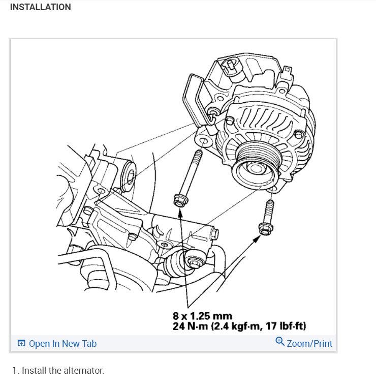

My air conditioning kept going in and out for a few months so I took it to Sears and they told me I needed a new AC compressor so I bought the correct part and had it replaced, at that same time I was having trouble with my battery and if I left a light on for a little it would die easily and even has not started when no lights were left on. I got the car jumped a couple of times but most times I just waited 10 minutes and kept trying until it worked - so I got that replaced this Saturday when I replaced my AC compressor. I was low on gas today and pulled into the gas station and turned my car off and pulled out my wallet to find I didn't have my debit card and when I went to turn on my car it wouldn't start. I assumed it was just low on gas and when I filled gas in it wouldn't start. I kept trying and was about to call triple A when I tried again 15 minutes later and it started. Is it my alternator ? Or does this sometimes happen with new batteries? Keep in mind that I had been driving it on the freeway for 20 minutes before I got gas and it died on me- shouldn't it have been charged by me just driving it ? Thank you for your help.
Aug 4, 2015 at 9:03 PM
HMAC300
  • CAR REPAIR CONTRIBUTOR
  • 48,601 POSTS
It does sound like the alternator needs to be replaced here is a guide to help walk you through with instructions in the diagrams below to show you how on your car.

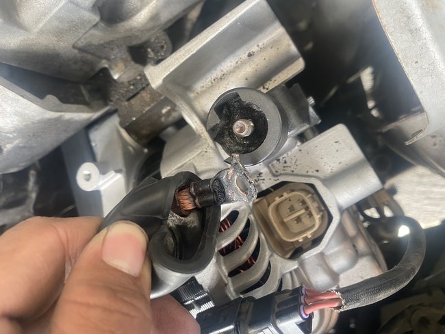

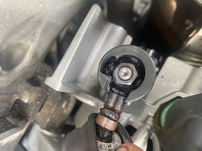

Two days ago I installed a new alternator into my car because AutoZone had told me it was bad . Today my car wouldn’t start due to electrical issues . Then I checked and the main power wire on the alternator and it had melted the plastic around it . Can the alternator be overheating or do I need an upgrade of wires?
Jan 4, 2021 at 12:10 PM (Merged)
  • 110,190 POSTS
The fist thing I need to know is how much power the alternator is making. Here is a link that shows how that is done:
Here are a couple links you may find helpful.
Now, the voltage regulator is integral with the alternator. It could be bad and allowing the alt to over charge. Make sure none of the wiring is damaged or shorting.
Another thing that can cause a wire to melt is a poor connection. If the wire was left loose or is corroded, that can cause it to overheat.
If possible, take a pic of the affected wire and upload it for me to see. Also, let me know the results of the alternator test.
I will watch for your reply.

Well the car won’t even start.
  • 110,190 POSTS
Okay. Without it being able to be started, the only thing you can do is remove the alternator and have it bench tested. When you say the car won't start, do you mean the battery is dead or is it cranking and not starting? By any chance, were you able to get a pic of the wire in question?
R.CORONA
  • 5 POSTS
The dash lights turn on but it doesn’t start. so yes I’m pretty sure the battery is dead.
R.CORONA
  • 5 POSTS
Another picture.
Jan 4, 2021 at 12:11 PM (Merged)
  • 110,190 POSTS
It looks like the insulator on the alternator melted. Was it good and tight? That is the only thing I can think of at this point to create that much heat. I was thinking the insulation on the wire melted. Am I correct on my assumption that it is limited to the alternator itself?

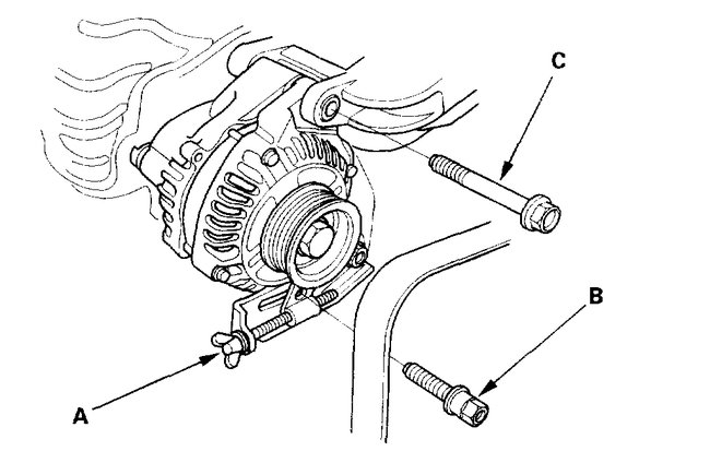

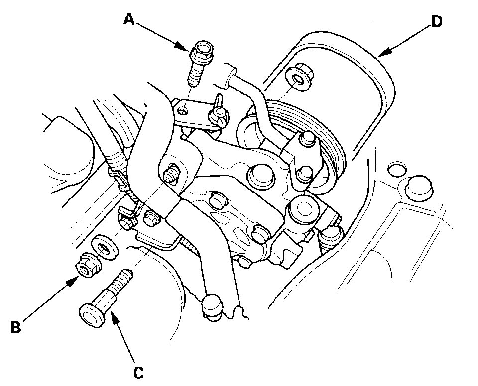

Here are the directions specific to your vehicle for replacing the alternator. I'm adding them so you can see the process and how everything should be mounted.
2005 Honda Civic L4-1.7L SOHC
Replacement
Vehicle Starting and Charging Charging System Alternator Service and Repair Procedures Replacement
REPLACEMENT

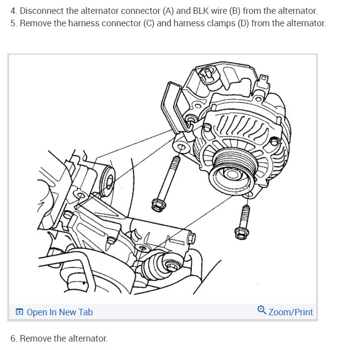

Alternator Replacement
1. Make sure you have the anti-theft codes for the radio, then write down the customer's radio station presets.
2. Disconnect the negative cable from the battery.
pic 1
3. Remove the adjust plate mounting bolt (A), locknut (B), and mounting bolt (C), then remove the power steering (P/S) pump belt (D) and pump without disconnecting the P/S hoses.
pic 2

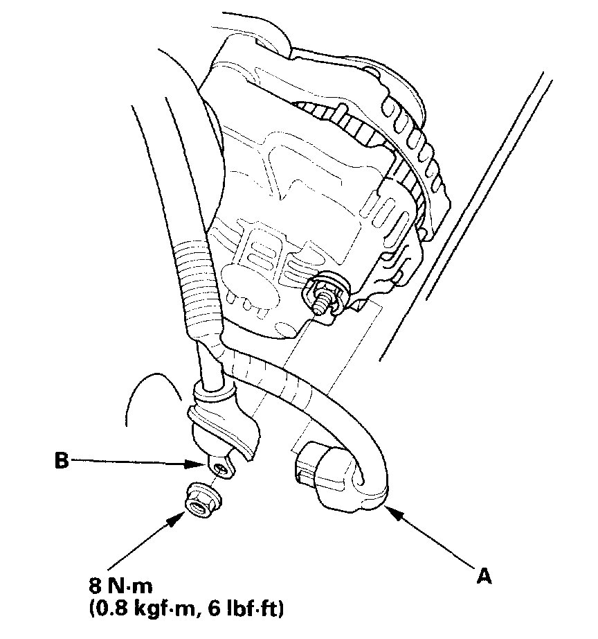

4. Disconnect the 4P connector (A) and alternator cable (B) from the alternator.
pic 3
5. Loosen the adjusting boll (A), and remove the lock bolt (B) and mounting bolt (C), then remove the alternator belt and alternator.
6. Install in the reverse order of removal.
7. Adjust the alternator belt tension or the alternator-A/C compressor belt tension.
8. Enter the anti-theft codes for the radio, then enter the customer's radio station presets.
9. Set the clock.
10. Do the engine control module (ECM)/powertrain control module (PCM) idle learn procedure.
Check that and let me know what you find.

Yes the insulator on the alternator was melted.
RENGELKING58
My grandson removed the power steering. Does that make a difference?
  • 110,190 POSTS
For that to have happened, I suspect there was a poor connection. Anytime electric jumps or arcs, it creates heat. I would return the alternator, get a new one, and confirm it is making a good connection. Then, check the alternator output with a multi meter or volt meter.

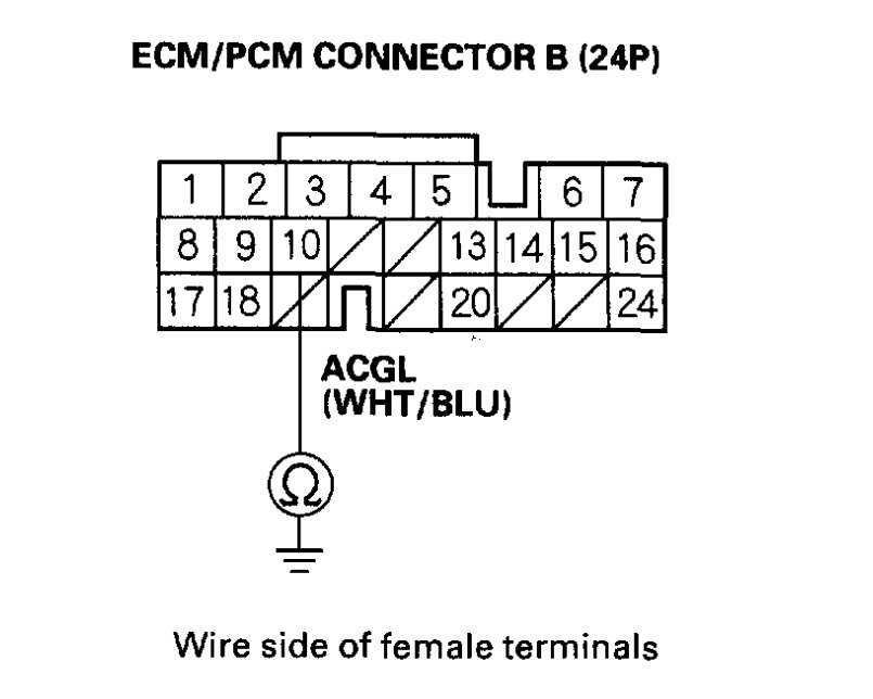

DONAVAN JARMAN

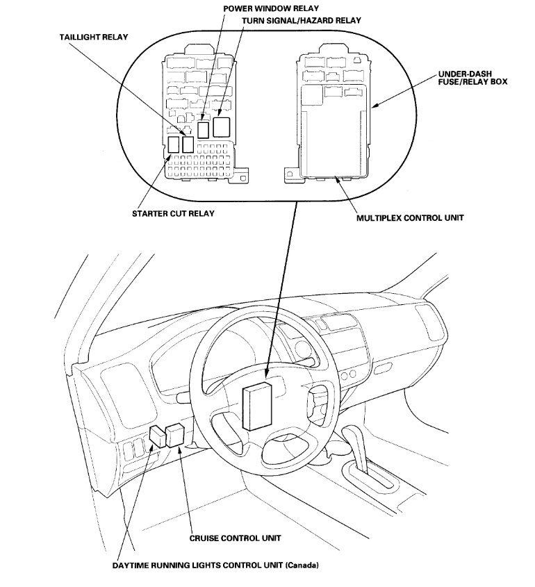

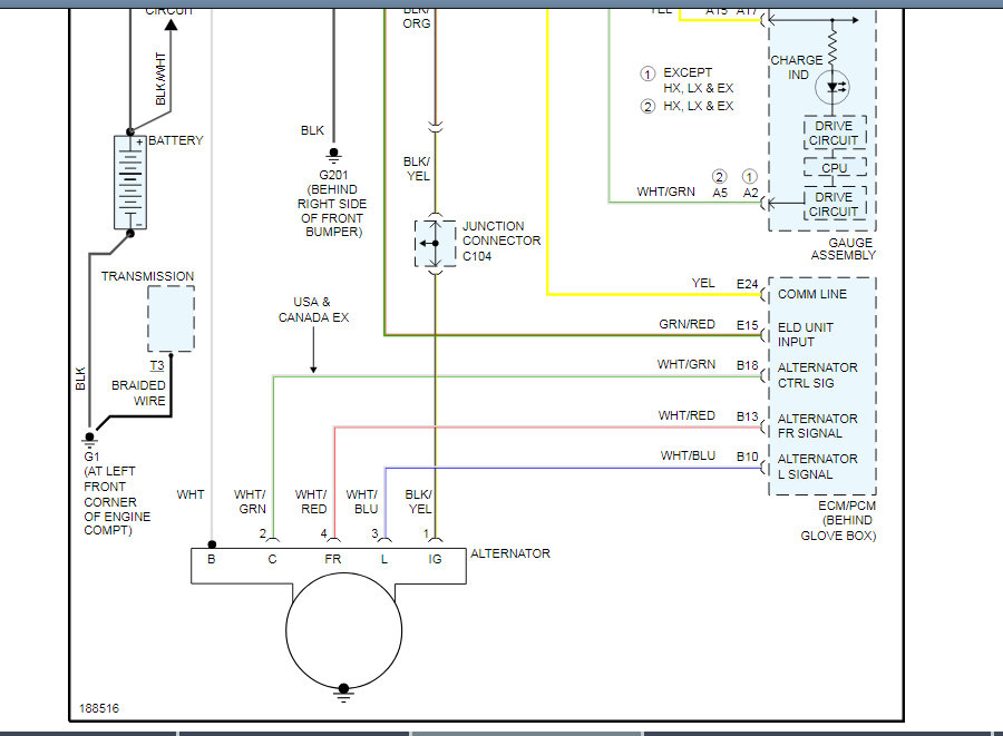

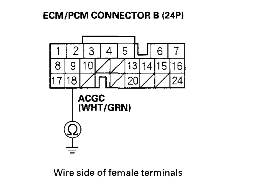

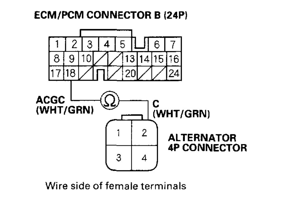

One night while driving home, my lights got dim, my radio started cutting off and on, my car charger cut off. I didn't think to much about it at the. The next morning it wouldn't start. I jumped it off and got it to Walmart and bought a new battery thinking that may have been the only problem. After two days, the same problem happened. I thought the alternator had gone out. After replacing the alternator, I figured it would charge the new battery back up. After a day or two I had the same problems again. I took the battery back and was able to get a new one but it didn't help. I was barely able to get it to a mechanic shop the next day. They told me they couldn't do a diagnostics test because the alternator was only putting out 9v. I took the alternator back thinking I might have just got a bad one and swapped it for another one. After installing, no difference in the car. With a new alternator and belt, it's still not charging the battery. I've checked all fuses, plugs, replaced battery terminals, checked for any parasitic draw, I can't figure it out. The battery will read 12.3v or less with the car off. When running or idling, it doesn't go any higher than when it was off. Any ideas?
SCGRANTURISMO
  • 4,897 POSTS

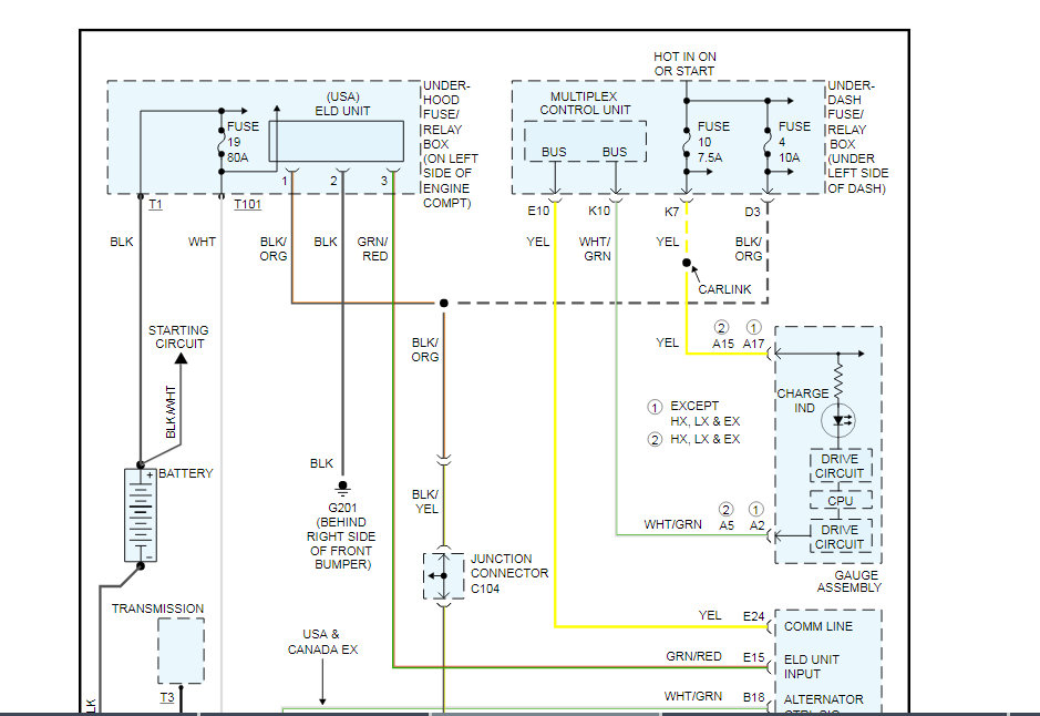

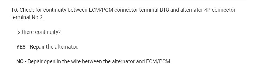

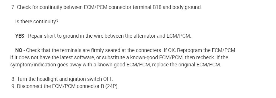

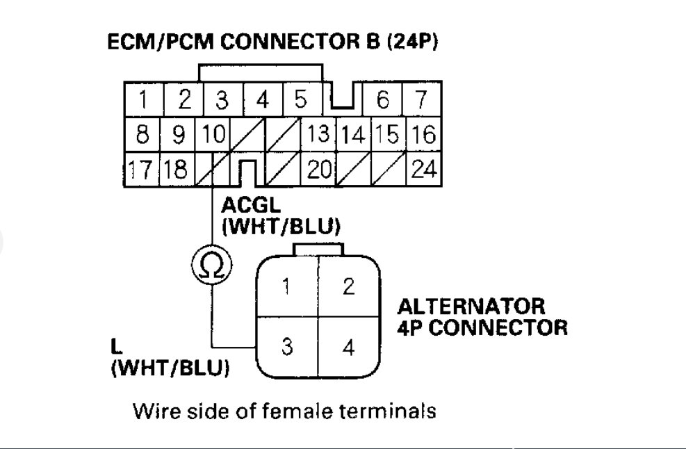

This could be a problem with the voltage regulator or the electrical connector or wiring from the alternator to the battery. In the diagrams down below I have included a wiring diagram of your vehicle's charging system, for reference, and a guide from the vehicle manufacturer for tracking down exactly what the problem is. Please go through these guides and get back to us with what you are ale to find out.
Thanks,
Alex
2CarPros

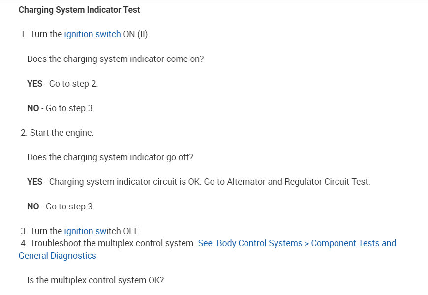

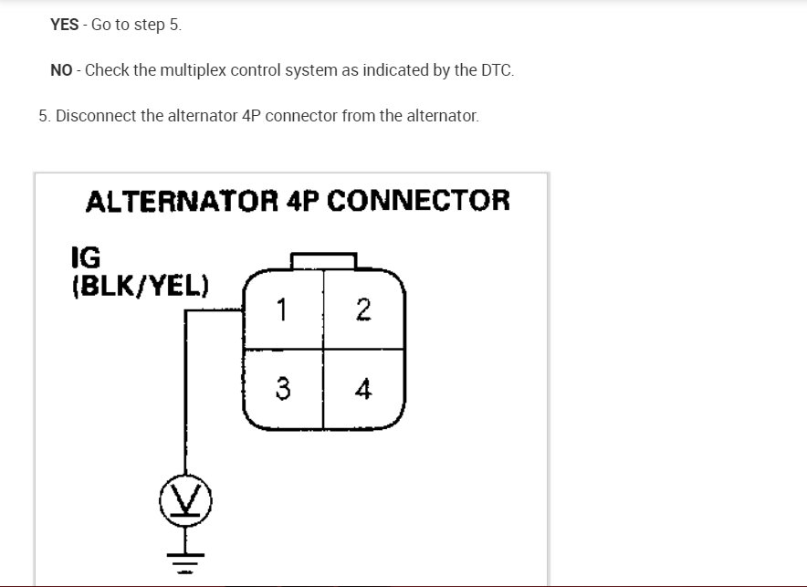

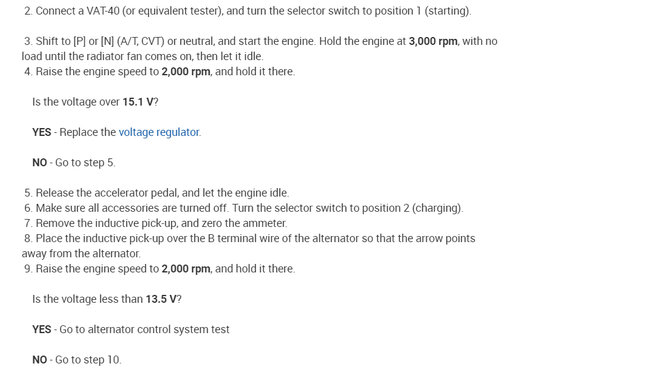

  • 54,350 POSTS

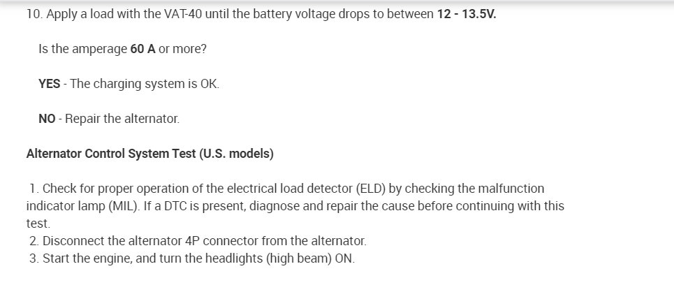

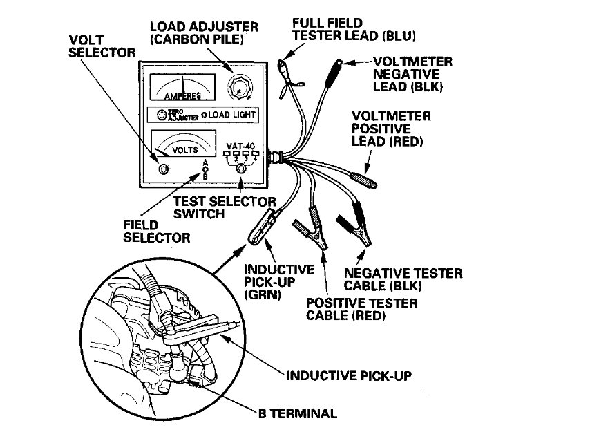

Here is a guide to help you test the alternator:
I have seen the multiplex control unit cause this issue BTW. Check out the diagrams (below). Please let us know what happens.

Hi iamharleyguy, ALTERNATOR Removal 1. Ensure you have the anti-theft code the radio. Write down the frequencies for radio's preset buttons. 2. Disconnect the negative cable from the battery. 3. Remove the adjust plate mounting bolt "A", locknut "B" and mounting bolt "C". Remove the Power Steering (P/S) pump belt "D" and pump without disconnecting the P/S hoses. See Fig. 9 . 4. Disconnect the 4 pin connector "A" and alternator cable "B" from the alternator. See Fig. 10 . 5. Loosen the adjusting bolt "A", and remove the lock bolt "B" and mounting bolt "C". Remove the alternator belt and alternator. See Fig. 11 .
https://images.2carpros.com/forum/automotive_pictures/192750_Alternator02Civic01_1.jpg
Fig. 9: Removing Alternator Components Courtesy of AMERICAN HONDA MOTOR CO., INC.
https://images.2carpros.com/forum/automotive_pictures/192750_Alternator02Civic02_1.jpg
Fig. 10: Disconnecting 4-Pin Connector Alternator Cable From Alternator Courtesy of AMERICAN HONDA MOTOR CO., INC.
