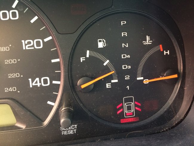

This has happened about four times in the last four months:
I try to start the car and it is dead. The clock is on but nothing else. The horn may or may not blow faintly. A few minutes later there is power to the radio, the windows and maybe the horn, but when I turn the key nothing. When I turn the key back one position I have flashing lights of the open door indicator.
I call for a jump, it starts, I get home turn it off its dead. I come out hours later it starts.
This has repeated in similar fashion at least four times.
Any idea what this could be?

Follow the smaller battery positive wire to the under-hood fuse box, and be sure that connection is clean and tight. Also, follow the smaller negative wire to the body and be sure that connection is tight and not rusty. Do not overlook loose or dirty battery cable connections. These guides can help us find the problem.
