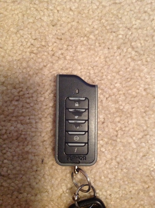

New ign sw, new lock cyl, two starters, three selinoids. complete new power supplypassing fuse box. Steering col was once replaced, cant find nsw, not on bot of column, not on trans?
May 1, 2017 at 10:12 PM (Merged)
ANONYMOUS
  • 0 POST
My car starter quit working. It was installed after we purchased the vehicle ( which was about 4 years ago). The brand is Python. I checked to make sure the switch by my knees on the drivers side is "on" and it is. I also changed the battery in the remote and it still doesn't work. Any ideas what else it could be???
WRENCHTECH
  • CAR REPAIR CONTRIBUTOR
  • 20,761 POSTS
You will have to contact the aftermarket manufacturer on that issue..
