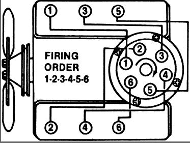

I need a diagram of the firing order of a 1991 2.8L gmc sonoma.

Welcome to the forum, my info showed this. Check out the diagrams (Below). Please let us know if you need anything else to get the problem fixed.
