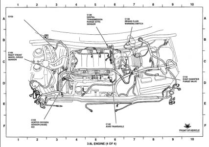

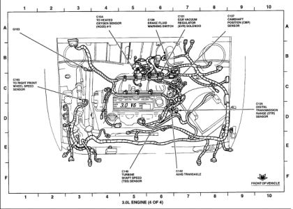

where is my trainsmission range sensor located on my vehicle?

Transmission Position Switch/Sensor
2000 Ford Truck Windstar V6-3.8L
2000 Ford Truck Windstar V6-3.0L
