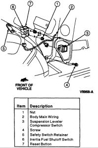

looking for fuel pump reset. Just put new fuel pump and fuel pump will not cut on

The inertia fuel shutoff switch is located behind the trim panel to the right of the rear passenger seat, below the jack.
