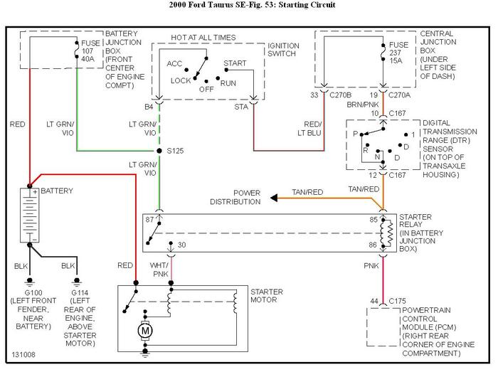

won't start-no crank. dead. radio, lights, heater, etc. all work fine. jumped socket 30 of starter relay to battery and starter motor does not turn. metered from ground to starter relay socket 85 with key to start and get +12 volts. all relays and fuses are good. the last part of the starter circuit is a wire from starter relay socket 86 to the pcm. what is this ? can it be my pcm that is preventing a start ? any way to bypass ? problem was intermittent for a day- now dead

This sounds like the starter has gone bad but to be sure this guide will help us fix it.

are the injectors showing 12v with key on? you could have a bad PCM?

Attached is the starting circuit schematic.
The relay receives its ground from the PCM and it could be a faulty PCM or the security system is armed.

two things to look at, one pull the connector off the crank sensor and plug its back in. if no start the pigtail at the starter may be one that ford put a technical service bulletin out on, they have a wire kit to fix it. look for any corrosion at starter

Fixed! it was the starter motor, I should have checked that first DOH!
