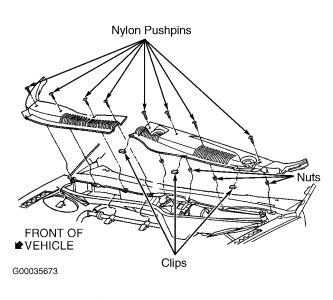

How do I get to the 3 rear spark plugs on my 2001 Ford Taurus 24V-DOHC? They are the 1,2,3 pistons. What is the best way to change those plugs?
May 23, 2021 at 11:40 AM (Merged)
BLACKOP555
  • CAR REPAIR CONTRIBUTOR
  • 10,386 POSTS
some claim to be able to remove the windshield wipers and the wiper cowl. and maneuver to it. but when i do it i always remove the upper intake manifold and reach back behind it and do it from there. Here is a guide to help you step by step with instructions in the diagrams below to show you how on your car.

BMRFIXIT
  • 19,053 POSTS
what do u have for engine (DOHC SOHC ) 1.Open hood and remove both windshield wiper pivot arms. Remove 8 plastic retainers from cowl vent screens to inner panels by turning 1/4 turn counterclockwise. Remove 5 clips retaining cowl vent screens to inner panels. Remove left and right side cowl vent screens from vehicle. Remove 4 bolts retaining ignition coil 4 and position out of the way. 2.Disconnect negative battery cable. Ensure left and right side cowl vent screens are removed. Disconnect electrical connector from ignition coil and remove 4 ignition coil hold-down screws. Remove ignition coil to access spark plugs on cylinders No. 1, 2 and 3. Disconnect electrical connector from Intake Manifold Runner Control (IMRC) actuator. Remove IMRC mounting screws, and lay IMRC actuator aside to access spark plugs on cylinders No. 4, 5 and 6. NOTE: Spark plugs must be marked so they may be installed into the same cylinder from which they were removed. 3.Disconnect ignition wires from all spark plugs. Loosen spark plugs and use compressed air to remove any dirt or foreign material from spark plug areas of valve covers. Remove spark plugs.
