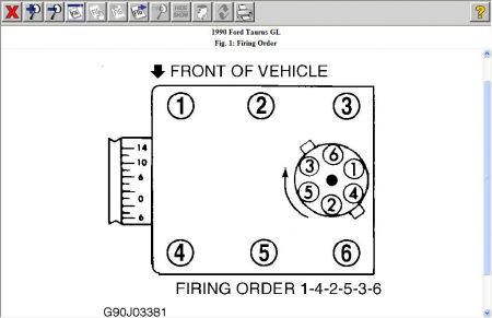

1990 Ford Taurus Distributer order
1990 FORD TAURUS
190,000 MILES • 6 CYL • FWD • AUTOMATIC
BSERRATO
I was changing the radiator hoses and took of some of the plugs on the distributer. I wanted to know what was the original order
