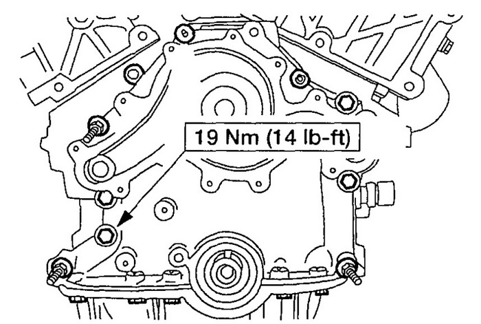

Feb 25, 2021 at 11:32 AM (Merged)

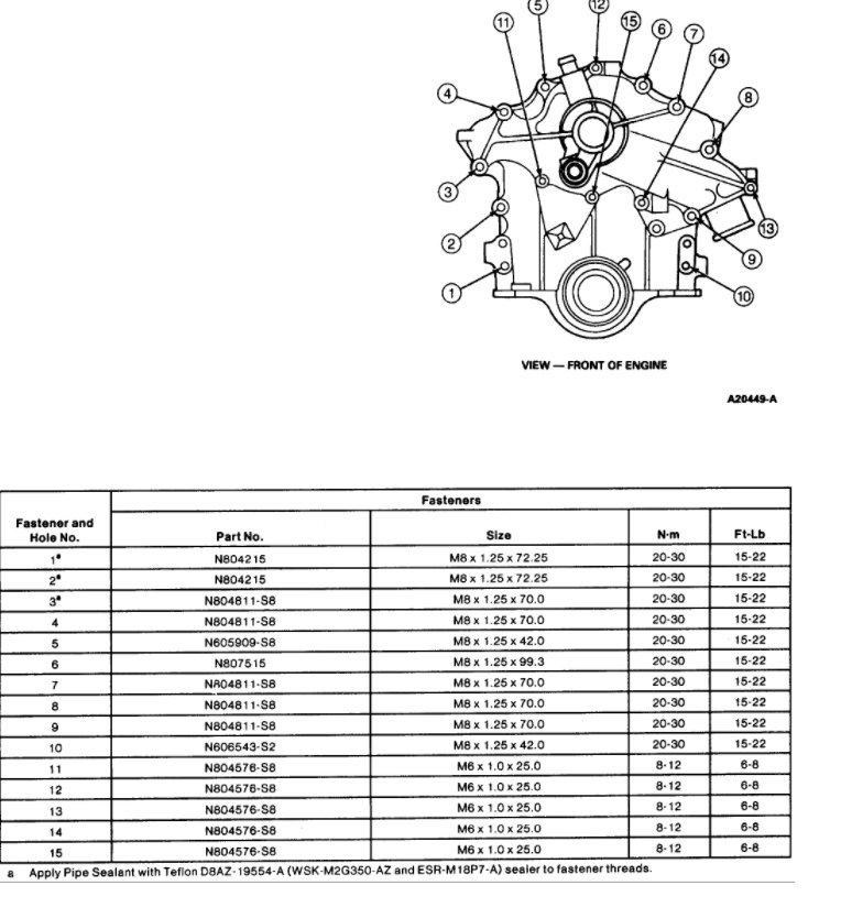

HMAC300
  • CAR REPAIR CONTRIBUTOR
  • 48,601 POSTS
that is called a front cover and water goes from teh pump into and ot of the block. pic enclosed.

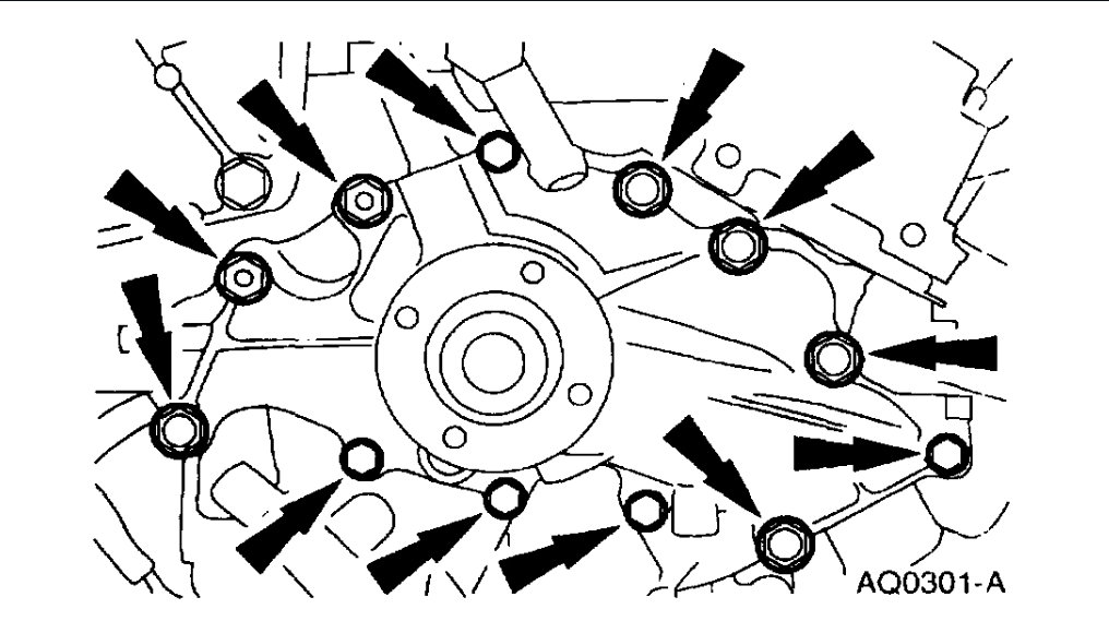

CHARLES R
How do you remove water pump
Feb 25, 2021 at 11:33 AM (Merged)
  • 75,992 POSTS
Removal and Installation Drain the cooling system. Remove the drive belt.
https://images.2carpros.com/forum/automotive_pictures/12900_w1_2.gif
Remove the bolts and the water pump pulley.
https://images.2carpros.com/forum/automotive_pictures/12900_w2_2.gif
Remove the bolts and the water pump. NOTE: Lubricate the water pump O-ring, with MERPOL(R) .
https://images.2carpros.com/forum/automotive_pictures/12900_w3_2.gif
To install, reverse the removal procedure. https://www.2carpros.com/kpages/auto_repair_manuals_alldata.htm

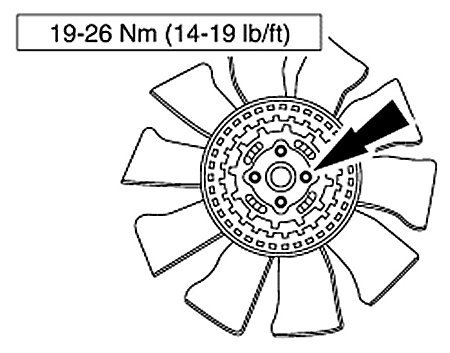

IBIZARRO
Engine Performance problem
2000 Ford Ranger 6 cyl Two Wheel Drive Automatic 112k miles

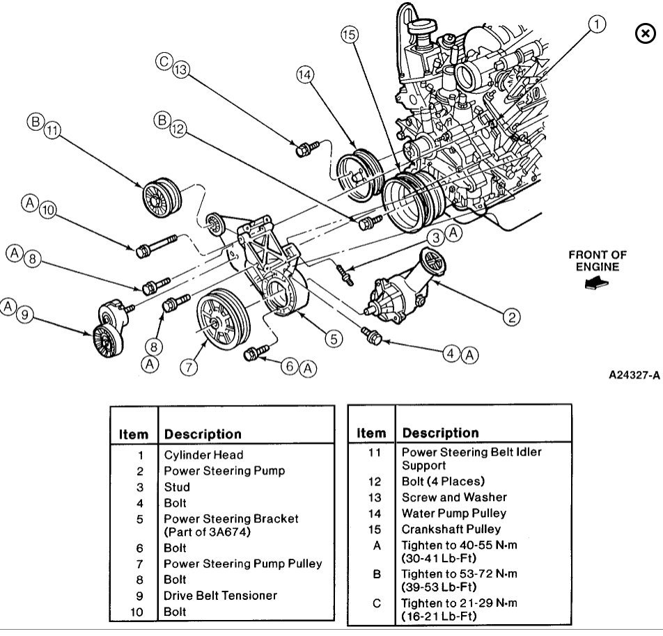

I am in the process of replacing the water pump in my 3.0L Ford Ranger, and I'm having a problem getting the pulley off. It says in the Haynes manual to brace against to of opposite bolts on the pulley hub and hold the pulley in place (with the belt still on) while turning the fan clutch nut counter clockwise. I can't get any leverage on the bolts or get anything to hold onto the pulley nuts to keep the pulley secured while I do this. The pulley is of a concave design, hiding the nuts away from sight also. Making another observation obvious to me- "Fords are a pain in the butt". Any ideas or procedures I should doing differently?
MERLIN2021
  • 17,250 POSTS
Try push down on the belt for extra tension, or use a deep sochet and hold the smaller bolt.
DAVE H
  • 13,384 POSTS
Removal (Ranger) Disconnect negative battery cable. Remove air cleaner duct. Drain cooling system. Using Fan Clutch Holder (T96T-6312-B) and Fan Clutch Wrench (T96T-6312-A), remove nut retaining clutch fan to pulley. Remove fan shroud and cooling fan as an assembly.
https://images.2carpros.com/forum/automotive_pictures/266999_tool_6.jpg
https://images.2carpros.com/forum/automotive_pictures/266999_AAA2_319.png

IBIZARRO
[quote="Dave H"]Removal (Ranger) Disconnect negative battery cable. Remove air cleaner duct. Drain cooling system. Using Fan Clutch Holder (T96T-6312-B) and Fan Clutch Wrench (T96T-6312-A), remove nut retaining clutch fan to pulley. Remove fan shroud and cooling fan as an assembly.
Thanks but I've already been down that route and tried that, I've been all over my Haynes manual and the internet trying to figure out how to get around this. None of the specialty tools work with the pulley and applying more tension to the belt does nothing either. It still slips.
98RANGERXLT
  • 301 POSTS
Its a 3.0 so it should be left hand threaad but im not sure.
IBIZARRO
[quote:dae7044b5c="Fordman16"]Its a 3.0 so it should be left hand threaad but im not sure.[/quote:dae7044b5c]
Yeah, it's a 3.0 efi. Should have left handed threads. Anyone suggest just removing the water pump with fan clutch and pulley still in tact?
SCHRIMPIEMAN
  • 166 POSTS
Removing the large nut to remove the fan blade is mandatory; you'll never get to those "hidden" bolts securing the water pump to the engine block because they are blocked by the pulley.
Left-hand or Right-hand? Solution: Just observe or imagine the fan spinning in it's natural motion. Stop the engine......you need to impact drive the large nut in the SAME direction as the natural spinning motion of the fan. Spray some penetrating oil to help in loosening the threads. You'll need an impact force to loosen the initial tension of the large nut. Put a large crescent wrench or the special tool and smack it with a hammer (careful not to ruin anything else around it). That's the only way, and increase tension on the belt as suggested by tugging on the tensioner.
Impact will likely be your only solution to break the nut free. And lot's of patience...

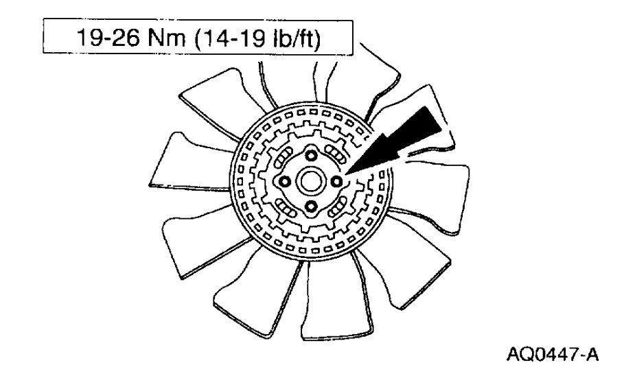

ACORPIOUS26
I removed the fan in order to get to the heads and now I'm trying to install it back to the water pump pulley, but for some reason when I thread it in the fan blade is hitting the A/C compressor. I installed the belt on all the pulley and it seems like that they are all aligned. My question is, how do I install it correctly without hitting the A/C compressor?
Feb 25, 2021 at 11:34 AM (Merged)
  • 110,190 POSTS
The cooling fan is mounted on the water pump, so I'm not sure how it could be hitting the compressor. I would think the compressor may not be mounted correctly.
Take a look through these directions. These are the removal and install directions for the cooling fan. Let me know if this helps. The attached pics correlate with the directions.

1999 Ford Truck Ranger 4WD V6-3.0L VIN U
Procedures
Vehicle Engine, Cooling and Exhaust Cooling System Radiator Cooling Fan Fan Blade Service and Repair Procedures
PROCEDURES

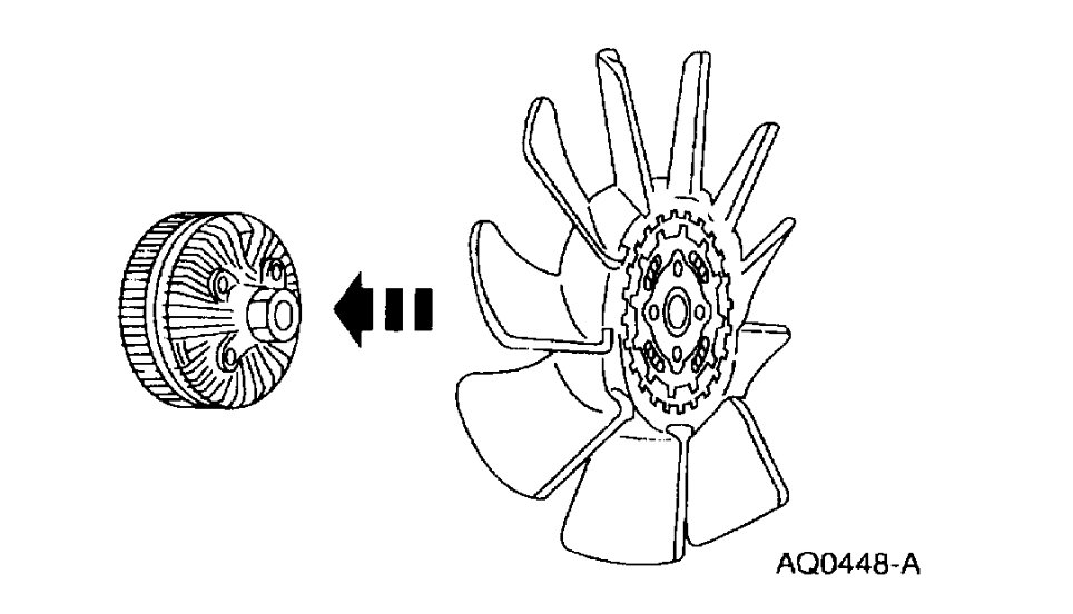

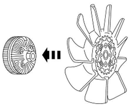

Fan Blade
1. Remove fan shroud. See: Fan Shroud > Procedures
pic 1
2. Remove the bolts.
3. Separate the fan blade from the fan clutch.
pic 2
4. To install, reverse the removal procedure.

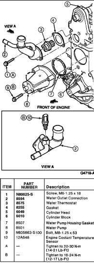

ACHILDS306
1996 Ford Ranger 6 cyl
Can you tell me how to replace a water pump on my ford ranger its 3.0.
Feb 25, 2021 at 11:35 AM (Merged)
BLUELIGHTNIN6
  • 16,542 POSTS
https://images.2carpros.com/forum/automotive_pictures/261618_Noname_2696.jpg
https://images.2carpros.com/forum/automotive_pictures/261618_Graphic_694.jpg

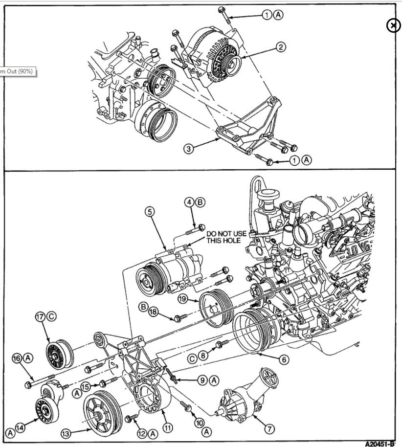

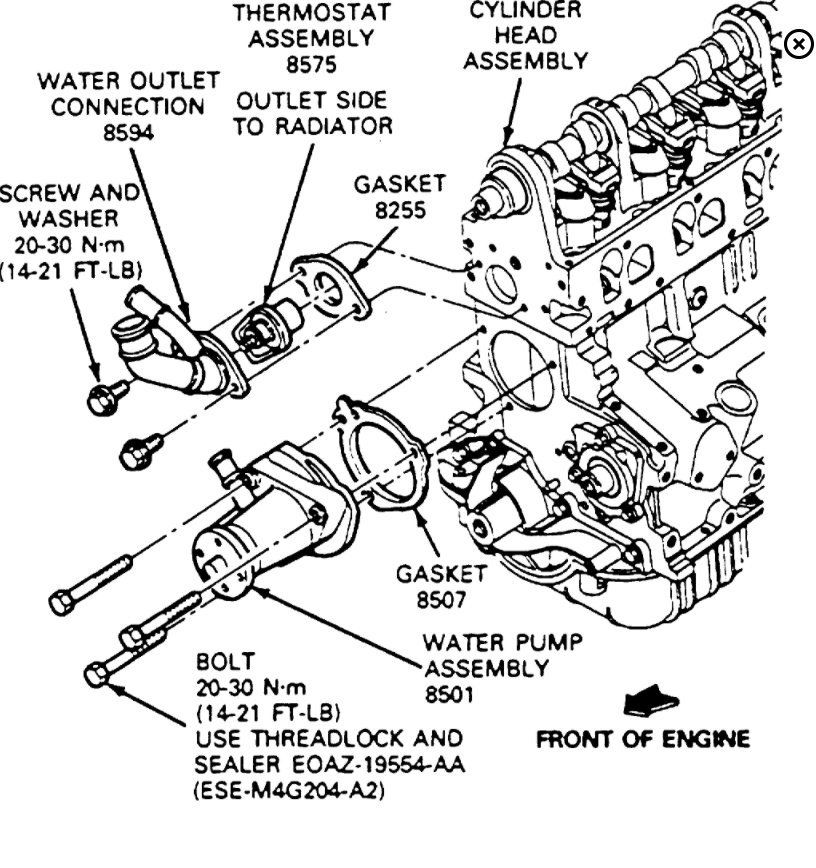

2003FLSTF
I was wondering how to replace the water pump and thermostat in a1995 ranger 2.3 lit. engine. Do i need to remove the fan and shroud to get to them. And I it difficult.
WRENCHTECH
  • 20,761 POSTS
Yes, you do have to remove the fan and shroud, along wwith all the belts.
REMOVAL AND INSTALLATION
1. Drain cooling system, then remove fan shroud attaching bolts and position shroud over fan.
2. Remove fan retaining bolts, then the fan and shroud assembly.
3. If equipped, remove A/C compressor and/or power steering pump drive belts.
Fig. 23 Water Pump Replacement
4. Remove water pump pulley, then the vent tube to canister, Fig. 23.
5. Remove heater hose to water pump, then the timing belt outer cover.
6. Remove lower radiator hose from water pump.
7. Remove water pump attaching bolts and the water pump.
8. Reverse procedure to install.
