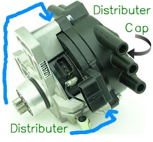

Did you replace the cap or whole distributer??
https://images.2carpros.com/forum/automotive_pictures/30961_dist_1.jpg
The whole distributer is covered by a distributer cap.
