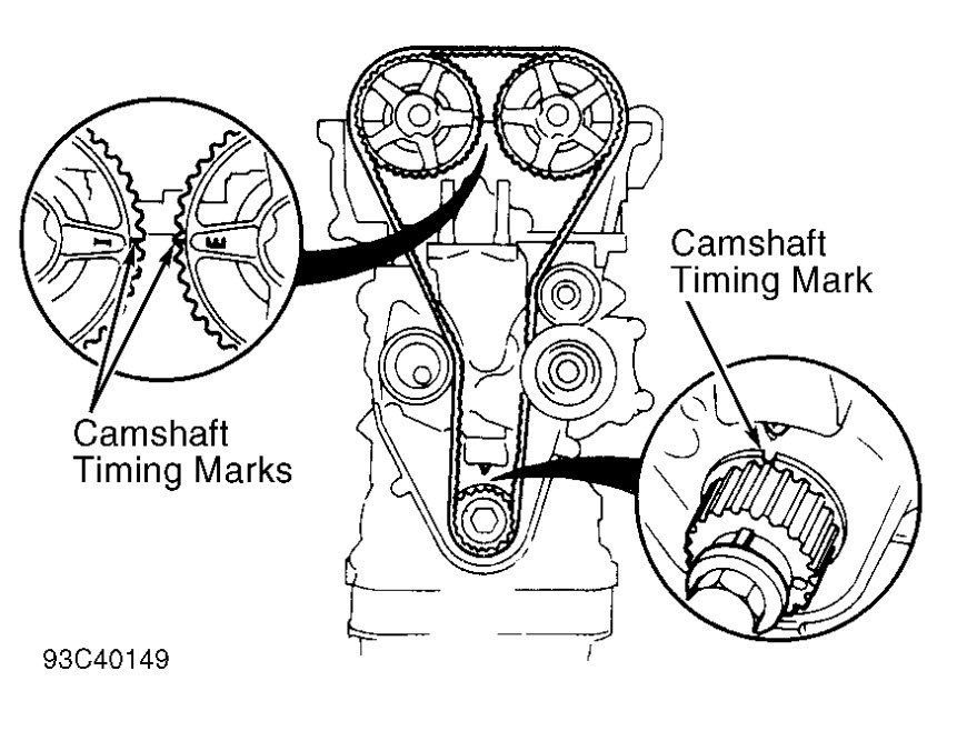

I recently replaced my water pump on my car, the timing belt got taken off and when I put it back on it ran like crap. So I took it off and tried timing it all marks are lined up but it won't fire. What am I doing wrong?

Double check all your alignment marks. Also, check to make sure the plug wires are in the correct order. I have attached pictures of both.

On my distributor cap is marked numbers differently than shown in the picture u gave me. Should I disreguard the numbers on the cap?

Only if you have changed them. The picture I sent is from a Mitchel service manual for the GT 2.5L. It should be correct, but... If the car ran the way it is now, you must be correct. Did the original timing belt break

I did everything you said all marks are alligned plug wires in the order illustrated in the picture still no fire

I also noticed the rear mark is off roughly 4 teeth would that keep it from starting?
Nov 13, 2011 at 7:15 PM
  • CAR REPAIR CONTRIBUTOR
  • 110,190 POSTS
Yes, that will prevent it from starting. That needs aligned.

Replaced timing belt. not sure which marks to line up on sprockets.

see pictures for align marks and instructions. make sure to rotate twice and recheck after install. Do not turn engine over after removing belt.

I recently changed my water pump on a 1996 ford probe gt. to do this you have toremove the timing belt. I put it back on according to spec with both over head cams pointing to the #1 cylinder and the the #1 at TDC. it will not start. It is getting gas and spark. ( There are suppoesd to be marks on the heads? i cannot see them) pleasde help

Hello, Hope this helps... here is the timimg alignment mark locations....
https://images.2carpros.com/forum/automotive_pictures/188069_96probetimingaligndohc_1.jpg
https://images.2carpros.com/forum/automotive_pictures/188069_96probetimingaligndohc2_1.jpg
