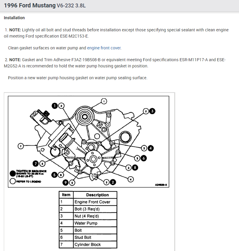

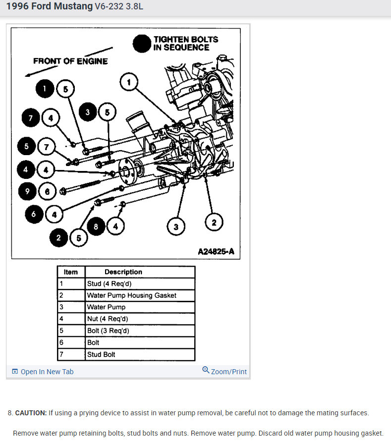

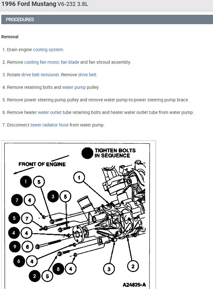

This overheating can be due to a faulty water pump.
If the impeller of the water pump is broken it will be unable to circulate coolant thru the engine and that will make it over heat.
Also as you mentioned you are not getting any heat out of the heater. That could be due to no coolant flow through the heater core. It can be for a clogged heater core or could be for the water pump not circulating coolant.
https://www.2carpros.com/articles/water-pump
https://www.2carpros.com/articles/symptoms-of-a-bad-water-pump
https://www.2carpros.com/articles/water-pump-replacement
I have attached the diagrams for your reference.
