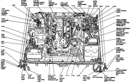

i need to know where the oil pressure switch is so I can replace it

Applicable to: 1992 5.0L/V8-302 & 5.8L/V8-350
Engine Compartment Components.
Lower LH Side Of Engine, Near Oil Filter
