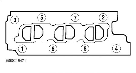

Can you tell me the torques specs for 2000 explorer 4.0 v6 lower intake manifold?

Tighten in the sequence shown in diagram..
Step 1 27 INCH Lbs (3 Nm)
Step 2 89 INCH Lbs (10 Nm)
Step 3 115 INCH Lbs (13 Nm)
Step 4 12 Ft. Lbs (16 Nm)
