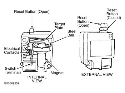

My son was in a minor accident where he impacted the from end of his explorer. There was no airbg deployment and the vehicle was still driveable.
The right tire was rubbing on the bumper so I pulled it out and removed the passenger side driving light. Now the vehicle will no start.
I'm thinking i may have triggered the fuel shut off switch, but I can't find it, and don't know how to reset it. Any thoughts?

Behind right kick panel inertia push up om button on bottom to reset.

[quote:b022de90e8="Docfixit"]Behind right kick panel inertia push up om button on bottom to reset.[/quote:b022de90e8]
That's what I thought, but can't find the button. I took off the kcik panel and the glove box. I still can't find the reset button

Looks like this
https://images.2carpros.com/forum/automotive_pictures/198357_Graphic_538.jpg
