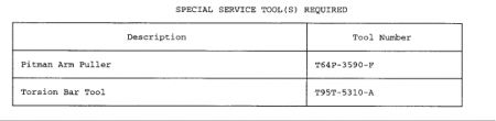

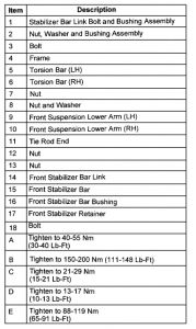

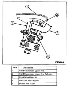

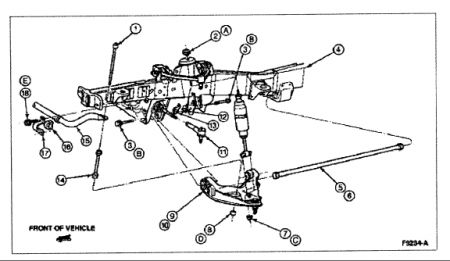

Removal
https://images.2carpros.com/forum/automotive_pictures/248015_j2_1.jpg
https://images.2carpros.com/forum/automotive_pictures/248015_j3_1.jpg
NOTE: Any time a front suspension lower arm is removed, the vehicle ride height must be checked. Place the steering wheel and steering system in the on-center position. Raise vehicle on a hoist. Remove wheel and tire assembly. Disconnect stabilizer bar link bolt from front suspension lower arm. Remove the two nuts attaching the front shock absorber to the front suspension lower arm assembly. NOTE: After removing the front shock absorber, support the front suspension arm bushing joint and front wheel spindle to prevent damage. Remove the upper nut and washer retaining the front shock absorber. Remove the front shock absorber. Support the vehicle with safety stands under the jacking pads, and lower the hoist but maintain working room. Remove torsion bar. Loosen the two front suspension lower arm pivot bolts. Remove the cotter pin and loosen, do not remove nut attaching the front suspension lower arm ball joint to the front wheel spindle. Using Pitman Arm Puller T64P-3590-F, loosen the front suspension lower arm ball joint. Remove the puller tool. Supporting front suspension lower arm with a jack, and remove the ball joint nut.
https://images.2carpros.com/forum/automotive_pictures/248015_j4_1.jpg
Raise the front suspension lower arm and disconnect front wheel spindle from the front suspension lower arm ball joint. Remove the bolts and nuts retaining the front suspension lower arm to the front crossmember. Remove the front suspension lower arm. Replace entire front suspension lower arm assembly-to-service bushings and ball joints. Installation
