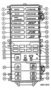

1995 Ford Explorer 6 cyl Two Wheel Drive Automatic
which relay or fuse goes to the fuel pump?car was running shut it off and now i dont hear fuel pump and it wont start.it was idling really rough like it wasnt getting any fuel.if i do have to change fuel pump is t in the tank or onthe frame rail?
Jan 15, 2009 at 6:22 PM
DAVE H
  • CAR REPAIR CONTRIBUTOR
  • 13,384 POSTS
Fuel Pump Relay.....#23 In power distribution block.
https://images.2carpros.com/forum/automotive_pictures/266999_box_2.jpg
FUEL PUMP Removal Release fuel pressure. See FUEL SYSTEM PRESSURE RELEASE under FUEL SYSTEM. Remove fuel tank. Using fuel tank lock ring wrench, carefully rotate lock ring counterclockwise to release pump. See FUEL TANK LOCK RING WRENCH IDENTIFICATION table. Remove fuel pump from tank.
