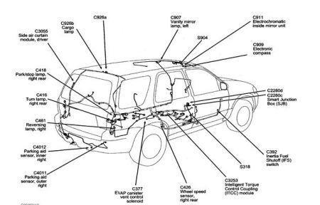

2005 Ford Escape fuel shut off switch
BROCK23
MEMBER
2005 FORD ESCAPE
Electrical problem
2005 Ford Escape 6 cyl Two Wheel Drive Automatic
were located fuel pump not working
Friday, March 27th, 2009 AT 2:18 PM
BLUELIGHTNIN6
MECHANIC
16,542 POSTS
Base of right door pillar, near kick panel, pictured below..
Also inspect fuel pump relay, it is located in battery junction box under hood.
