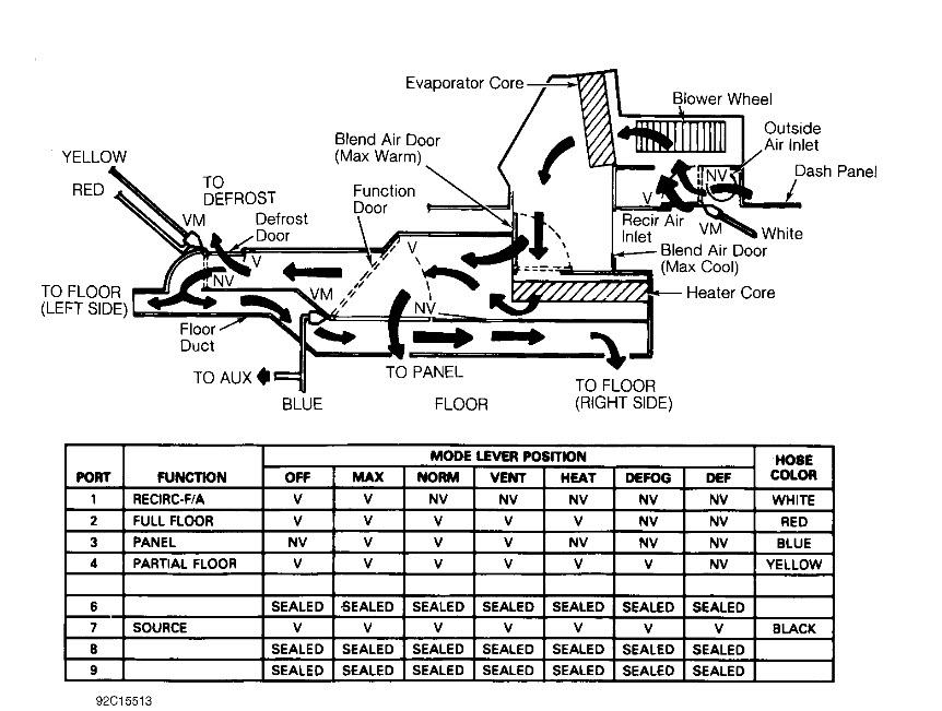

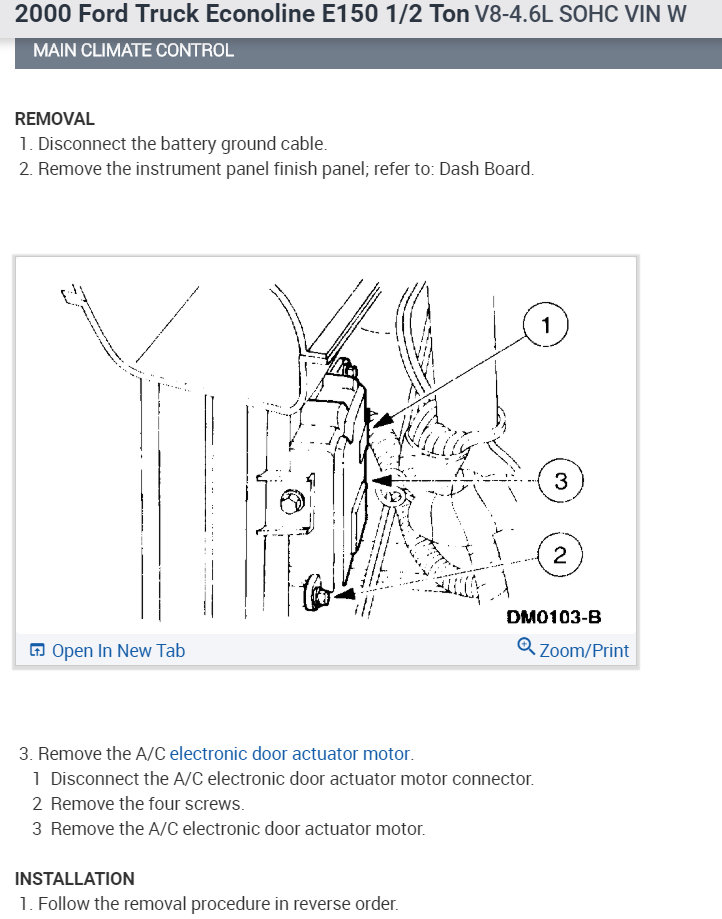

Our van is blowing out hot air only. Air does work - but the temp control that you change from hot to cold is stuck on hot. During the winter I couldn't get the heat to work - now it only blows out hot air.

It sounds like the temperature blend door actuator is not working here is a guide to help walk you through the steps and diagrams below to show you how on your car.
Check out the diagrams (Below). Please let us know what you find. We are interested to see what it is.

Thanks for this post I got a new actuator for $56.00 all fixed I love this site

The low readings indicate the evaporator is cold you should be getting 38 vent temp. So the most likely cause is outside air must be getting into plenum after it passes through evap. Make sure recurcilate door is closed far right side pass. Does system work in all modes ie. def,floor?
Is fan flow good?
Was evap a snug fit so air could not get by it and did you notice blend door had the foam insulation on it?
It either air getting or fan forced air is giong by evap instead of through it to cool.

In my 99 (and most likely for most years) the design of the Auxiliary Heat-A/C is such that heat only comes out of the integrated floor registers. A/C only comes out of the headlinger vents. When the front function selector is set to FLOOR or MIX, the auxiliary system send air to the floor vents. There is a typo in my manual that states that also in VENT position the auxiliary air is directed to the floor. Mine is directed to the headliner vents (and maybe floor). The manual counters itself in the very next paragraph by stating seperately, in the VENT position, the auxiliary unit will be recirculating interior air to the "discharge registers" (having never defined whether this refers to the floor, headliner or both registers). The front VENT air goes through the blend door so it will pick up heat if you set the temp control to warm. The rear unit has only a damper door to direct air and no blend door to control temp.
