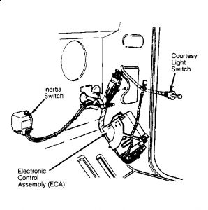

Where is this switch in a 1988 Ford Bronco I and ho do I turn in back o?

Your vehicle's inertia switch is located behind the left side of the dash, near the emergency brake mechanism.

I took off the fuse cover and looked up under dashboard for about 20 minutes. I found lots of electrical connections, but no switch that I could make out. I am somewhat mechanically inclined, but I've never had so much trouble locating a switch. Just to turn my gas back on. I appreciate the help that you have given me. But if there are any other suggestions. I would appreciate it. This is for a 1988 Ford Bronco II.

Sorry about that, at first you had it listed as a Bronco I ...for the Bronco II the inertia switch is located under the right side of the dash, on the firewall. I have a picture of it below.
https://www.2carpros.com/forum/automotive_pictures/261618_Graphic_26.jpg

Left dide dash above brake pedal

Try under dash on pass side firewall near floor you may have to pull back carpet.

I read that it is located under the dash on the passenger side. I took a quick look and didn't see it. Maybe it is behind the glove box or behind the kick panel. When its a little warmer I will try to find it. And get back to you. Unless you find it first.

It is under the dash just to the right (passanger) side of the transmission hump.

The inertia switch is underdash at right of transmission hump.
