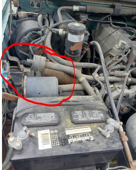

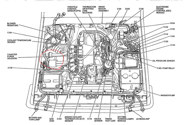

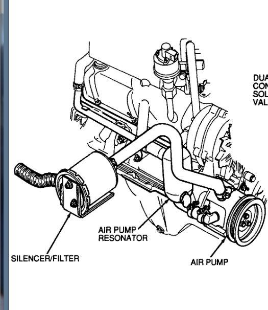

LEE PULSIFER
I have circled the two components in the attached image. One is blowing and the other is sucking. There flexible but hard aluminum hose coming off the one which looks like it should attached to the other but the hose and the attachment point are two different sizes. Maybe a piece is missing?
What is this and how to maintenance it? Would it account for surging idle?
Jun 18, 2020 at 3:06 PM (Merged)

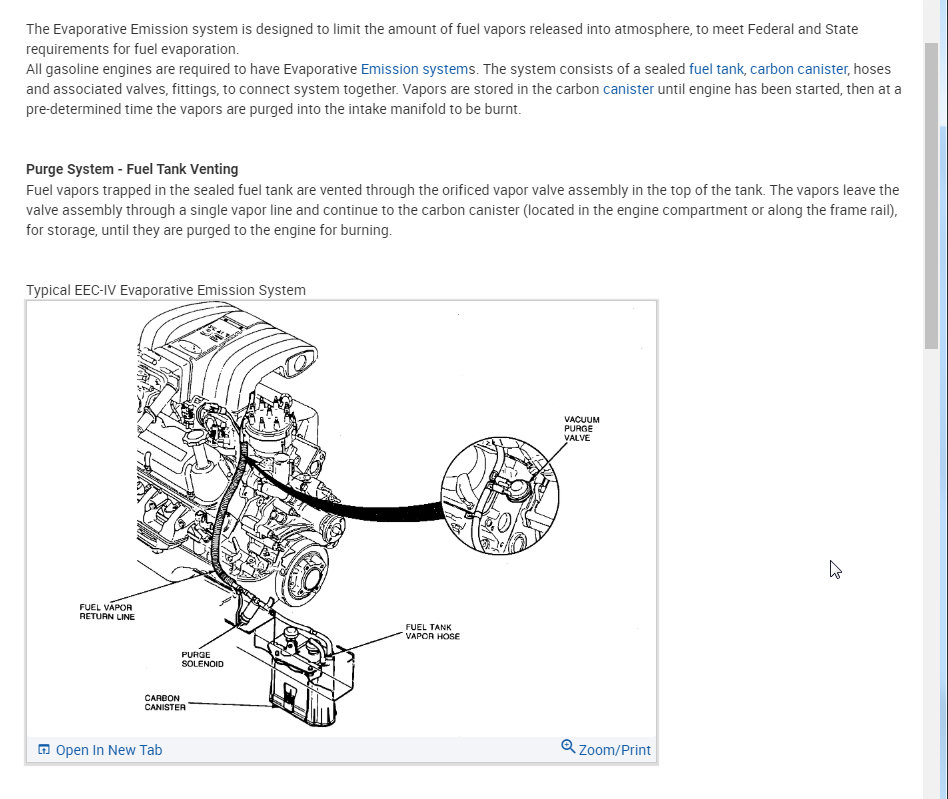

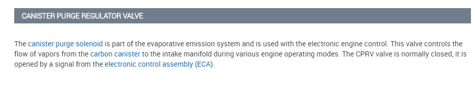

  • CAR REPAIR CONTRIBUTOR
This is the purge system. Basically it takes the fuel vapor from the tank and puts it into the engine so that the engine will run more efficiently and prevent the vapor from going into the atmosphere.
Yes, this can cause surging if this system is not operating properly. More then likely the purge valve is stuck open which means it is just dumping the vapor into the engine causing the RPM to surge.
Let me know if you have questions. Thanks

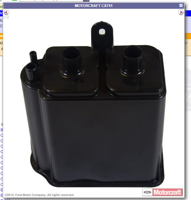

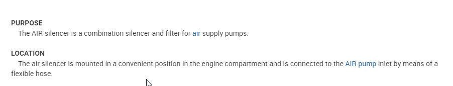

LEE PULSIFER
Thanks for the quick reply, however, that is not what I was asking, I have attached another picture. This is actually not my vehicle, but there appears to be a identical problem. The first cylinder directly behind the battery has a hard aluminum flex tube that is dangling (which I really cant see here) and the smaller round thing just behind it has an opening that looks like a hose should be attached on the side facing out. With the motor on, one is blowing and the other is sucking. Do these somehow go together?

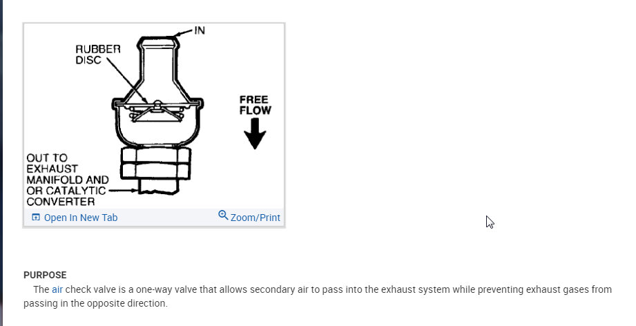

Okay. Sorry. That picture helps. This is part of the secondary air injection system. Basically is for CA emissions and it introduces air into the exhaust so that it helps cut down on the harmful emissions.
Take a look at this info. Thanks
