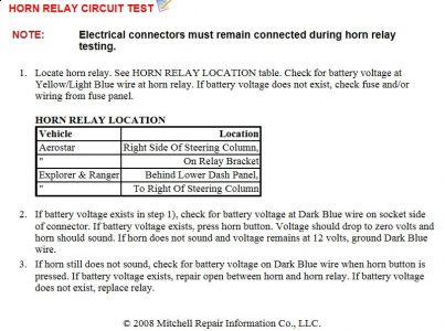

CRUISE CONTROL DOESN, T WORK AT ALL. ALSO THE HORN DOESN'T WORK. I DON'T KNOW IF THESE PROBLEMS HAPPENED AT THE SAME TIME.

Both problems could be related and might be caused by a faulty clock spring under the steering wheel.
If vehicle is equipped with Airbag, there is a possibility the indicator would show an error if the circuits are broken as well.
Does the cruise control light shows when main switch is turned ON?
Check the horn relay circuit.
