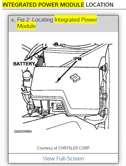

DOCFIXIT
  • CAR REPAIR CONTRIBUTOR
  • 18,828 POSTS
Fault with Front Control Module it controls all the stuff your have problem with. Located by battery will need to move Integerated Control Module out of way.
Jun 23, 2020 at 2:32 PM (Merged)
JJG_30
  • 11 POSTS
Changed the Front Control Module as recommended and still experiencing same problems as originally posted.

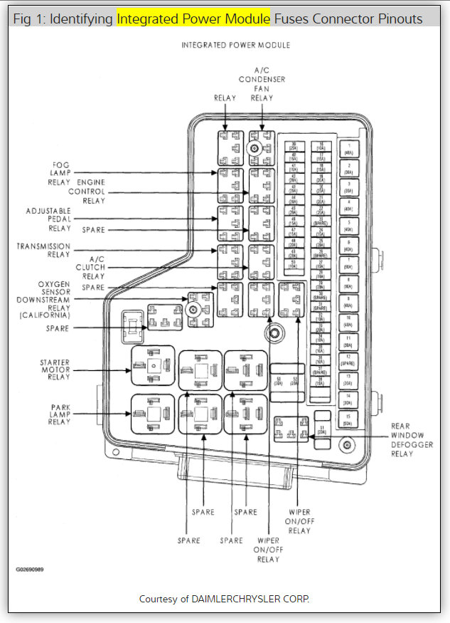

CB781
my odometer says no bus the instrument cluster doesn't work all lights are on and gauges are all not working, nor does anything on the steering column. no blinkers, high beam, cruise, four ways, brake lights and wipers don't work. after it sits for a while everything will work again for a while then the same thing. had the fuse box out and checked all the connections underneath it looks alright no corrosion. put dialectic grease on the contacts and put it back together. it worked for awhile then the same thing. any ideas. also when we tried to do a diagnostic with scan tool we were getting an error
Jun 23, 2020 at 2:33 PM (Merged)
WRENCHTECH
  • 20,761 POSTS
It sounds like you have a TIPM that is out which is common. You will need to have a shop program it in for you to get the car to work again. Here is the TIPM location so you can see what you are in for when doing the job.
(Check out the diagrams below.)
Cheers

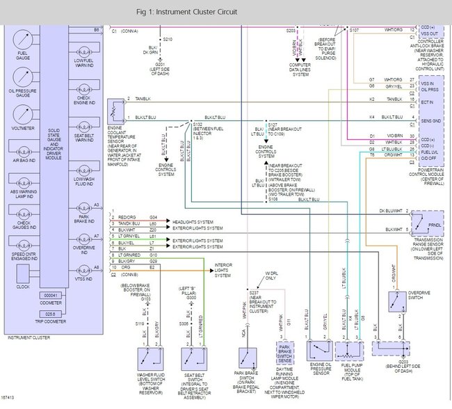

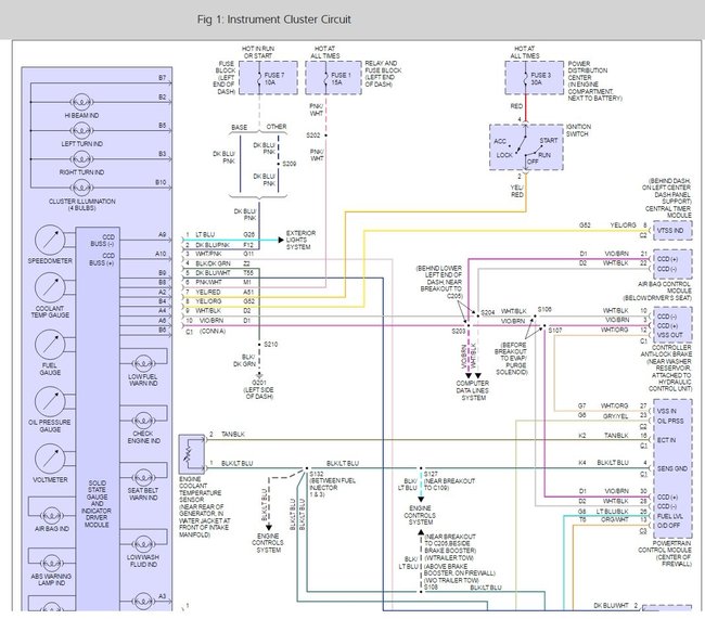

  • 54,350 POSTS
Okay, lets use this wiring diagram to see if the cluster is getting power and grounds. Also check fuse 1 and 7
and
Please check each power feed and ground
Best, Ken
