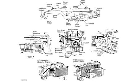

Does the engine reach normal operating temp? Are the heater hoses hot? The temp control uses a cable to operate door. With ac, no air comes through the heater core. With full heat, all the air comes through heater core. With the temp control in the middle, you get a mix. I'd have to locate temp cable and see if everything is working?
https://images.2carpros.com/forum/automotive_pictures/170934_97_ram_heater_1.jpg

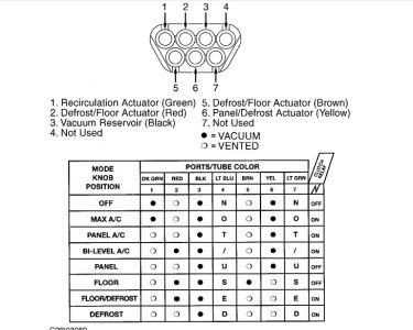

i noticed today that when i am driving the air does not come out good. when i let off the gas the air comes out more. it leads me t believe a vaccum leak. but were do i start? and is there a way i could get that diagram? i could not save it
Jun 23, 2021 at 9:38 AM
JDL
  • CAR REPAIR CONTRIBUTOR
  • 16,098 POSTS
Here is the vac diagram. My info shows that temp door is cable operated not vac. I don't have a better picture than the one posted.
https://images.2carpros.com/forum/automotive_pictures/170934_dodge_hvac_vacuum_1.jpg

I'd verify the temp reading, using a non-contact thermomenter. Your probably going to have to check actuator doors, under the dash.
LOWKEE
  • 47 POSTS
is there a way you can send me a better picture of the heater layout. its hard to see and i can not zoom it.
