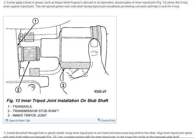

GALE PEPPEARD

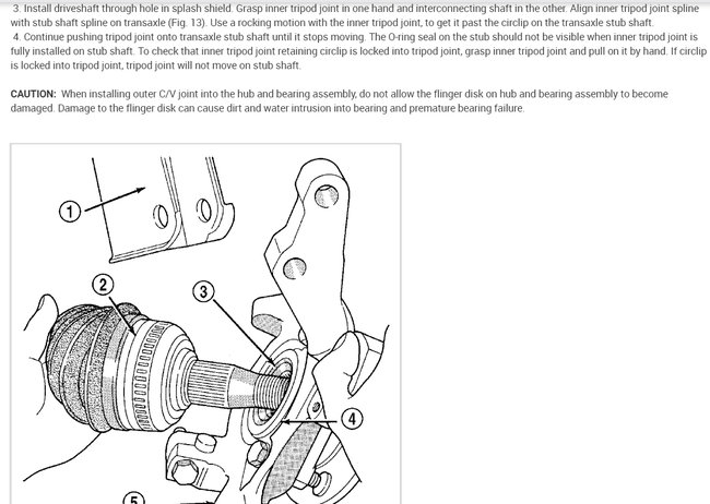

I have the CV joint or trans axle assembly out and discovered the shaft has slop in it and is the cause of the problem, vibration and knocking when no pressure is put on the shaft either giving the car gas or braking. There is a oil seal there and probably a bearing behind it. The book I have on the car does not show anything on the transmission or dis-assembly. What I was wondering is how to replace this axle. Or possibly a diagram. Thanks

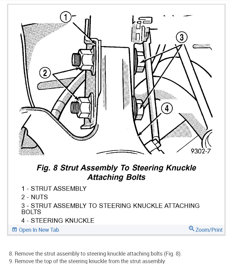

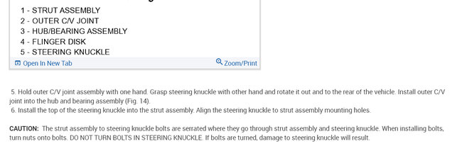

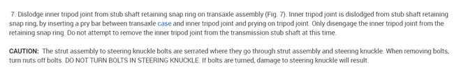

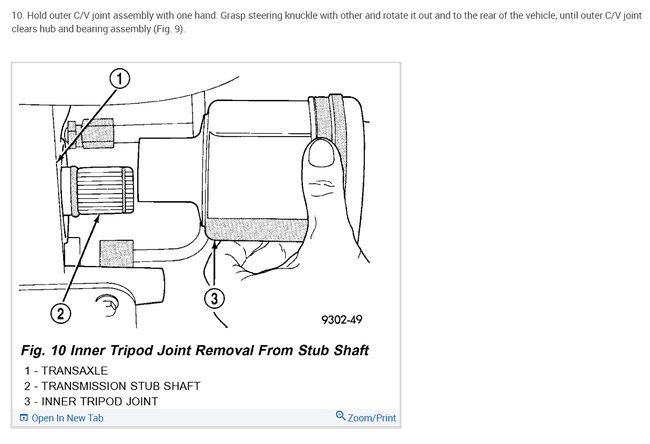

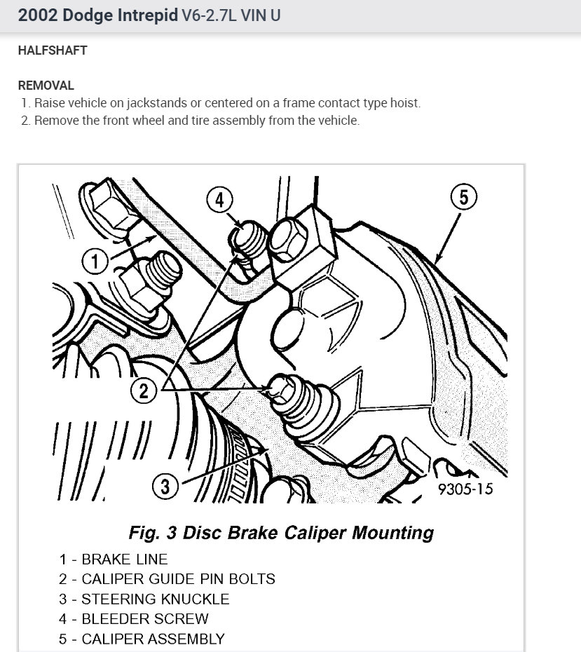

There is a guide to help walk you through the CV axle replacement with instructions in the diagrams below to show you how on your car.
https://www.2carpros.com/articles/replace-cv-axle

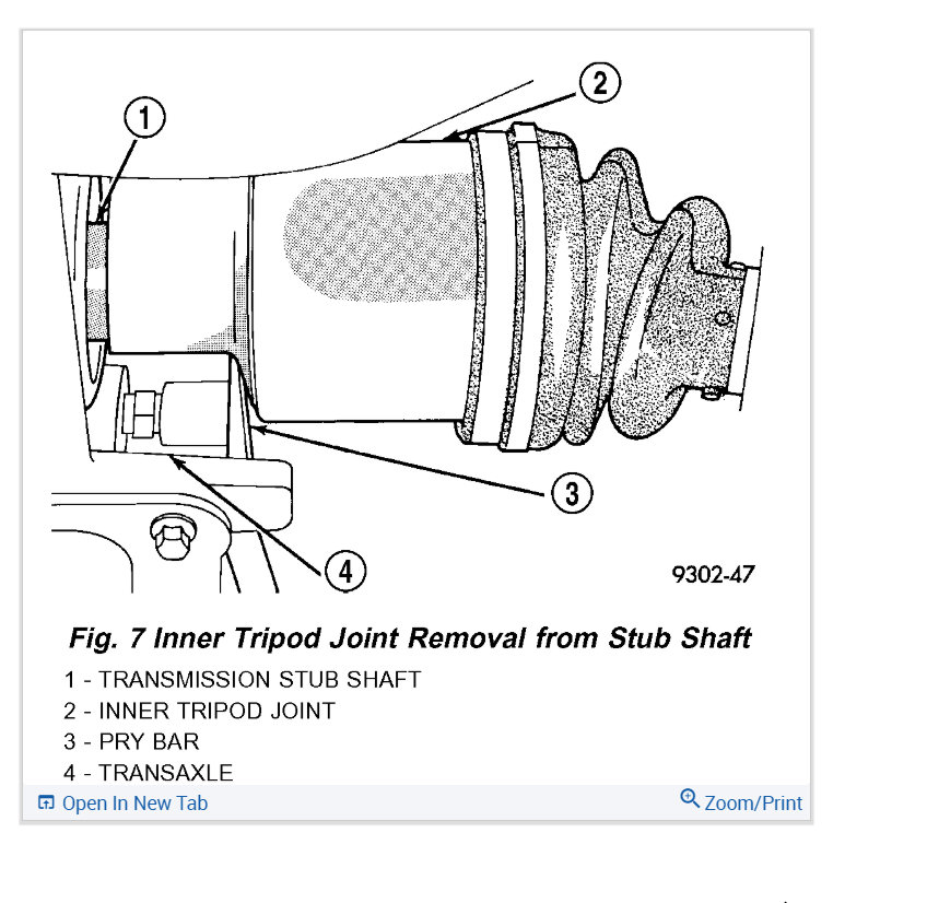

2000 Dodge Intrepid 3.5L:

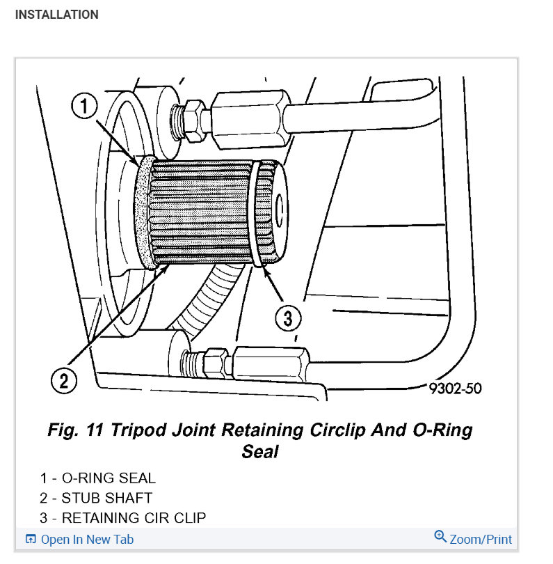

I recently noticed noise from the right front wheel. I suspected the wheel bearing because of the low-tone whine. This turned into a clunking snapping sound that would increase in frequency relative to vehicle speed.
I suspected the lower control arm with integrated ball joint, but I replaced these last year. Also, I put the front end up on stands and against my better judgement ran the car in drive so that I could inspect the noise while the wheels are spinning. Sure enough, I heard the wheel whine from the bearing. Curiously, I also noticed that the clicking and snapping sound was comming from the differential on the right side of the trans. Now it's posible that my ears were playing tricks on me and the noise was in fact comming from the wheel bearing since they are very close to each other.
Could the wheel bearing be causing this noise as well?
I wanted to open the differential cover to take a closer look, but on my way in there I ran into a snag. The right inner CV joint stubbornly will not slide off of the differential stub shaft. I know that there is a cir-clip on the stub shaft that retains the inner cv joint, but after 3 hours of prying and a bent pry bar I gave up. Is there a trick to this?
Should I just replace the wheel breaing, forget about the differential for now and hope for the best?
Thanks.
Apr 13, 2020 at 7:00 PM (Merged)
CH112063
  • CAR REPAIR CONTRIBUTOR
  • 1,320 POSTS
I know how hard it is sometimes to get this shaft out. I USE A HUGE PRYBAR, AND LEAN INTO IT WHILE IT'S IN THE AIR ON MY LIFT. Sorry about my caps key, i am one handed now but just try the bearing for now, it mat be part of the reason your getting into the final drive and taking that cover off is a no-no. How about filling it with oil at the tagged filler and just putting a bearing in it for now. ok Let me know if you want to get into the differential before trying. ok
It may just be the joint your trying to remove that is noisey, and the wheel bearings go bad often.
ROBKACZOR
[quote:efb6bedf5b="ch112063"]
It may just be the joint your trying to remove that is noisey, and the wheel bearings go bad often.[/quote:efb6bedf5b]
Thanks, you were right. The bearing solved all of the noise in the right wheel well. It's very surprising to me that the bearing would cause all that clicking and snaping noise. Anyway, thanks again..saved me some un-needed work!

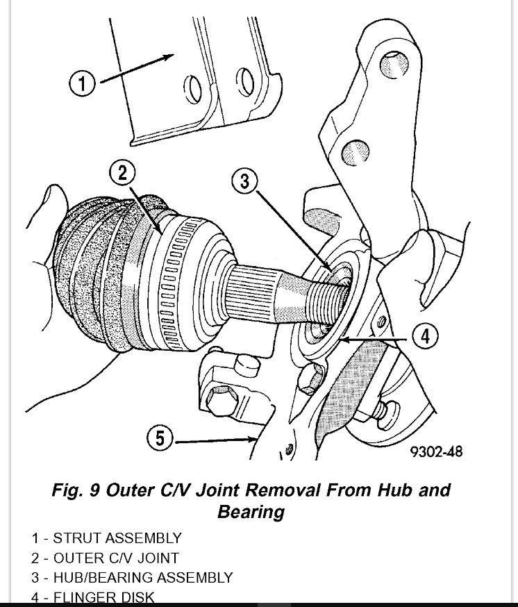

How do I remove/install the right side half shaft? I went
to replace the bearing/hub assembly but it's frozen onto
the spline. I can't get it off. Don't know if I have to
destroy the half shaft or not, but if I do, I want to
know how to replace it.
SATURNTECH9
  • 30,869 POSTS
First of all thank you so much for your donation.Let's start with getting the half shaft out of the hub.If you have to destroy the half shaft then we will cross that bridge when we come to it.Do you have salt and snow on the road's?If so then get some liquid wrench spray it generously into where the half shaft nut goes on.Let it soak in for a good 30 mins then take the half shaft nut screw it onto the threads until the nut sits flush with the end of the shaft.Now with the knuckle attached to the ball joint still smack the end of the shaft with large hammer.Try to hit it straight on.Let me know if it break's loose.

CRUISER74
I had sprayed PB blaster liberally to splines behine the
nut. Then used a 3lb stone hammer repeatedly with
the old nut threaded flush with shaft. All I managed to
do was destroy the threads on the nut, fortunately not
the threads on the shaft. Had replaced the bearing
on the left side already, so I used the old nut to fasten
the hub assembly and shaft back together so I can
drive the car. I didn't have a three prong puller to use.
Wondering if that with a judicial amount of hammering
on it when the puller gets tight would do it. Not sure
if it will. Don't know if the sawzall would cut the bearing
if I cut the hub away. Believe the bearing is hardened.
What do you think?
SATURNTECH9
  • 30,869 POSTS
Yeah the bearing and hub is hardened and would be hard to cut with a sawzall.See if you can get a hold of a puller.
