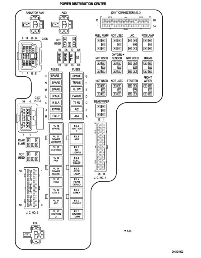

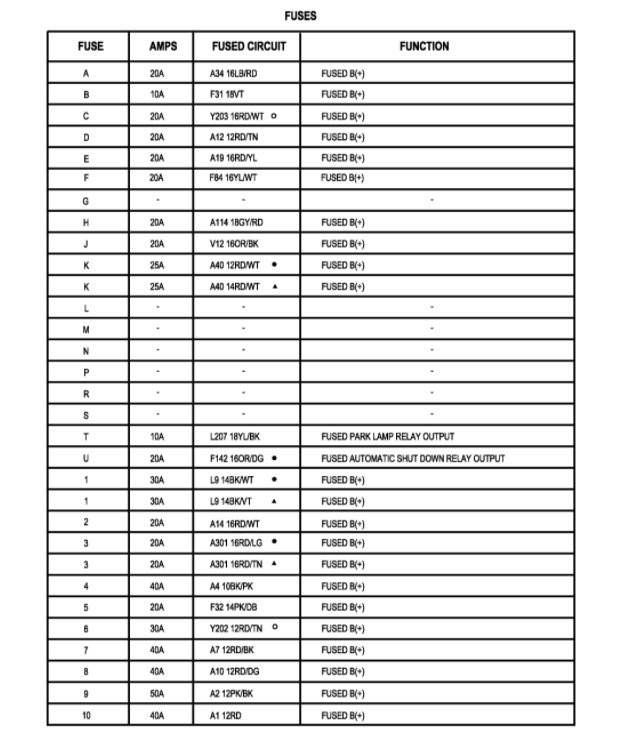

I have an 03 Dodge Durango 5.9 and my brake lights went out, I have tail lights but no brake lights. I checked all the fuses and there's no fuse for the brake lights. I replaced the brake light switch on the brake pedal and still nothing. Is there any other brake light switch anywhere??? Or how can I fix it??
Sep 1, 2013 at 5:37 PM
  • CAR REPAIR CONTRIBUTOR
  • 110,190 POSTS
lets start by checking the brake light fuse which is #5 20 amp in the under hood fuse panel. Here is a guide to help you with the fuse location in the diagrams below.
Check out the diagrams (Below). Please let us know what you find. We are interested to see what it is.

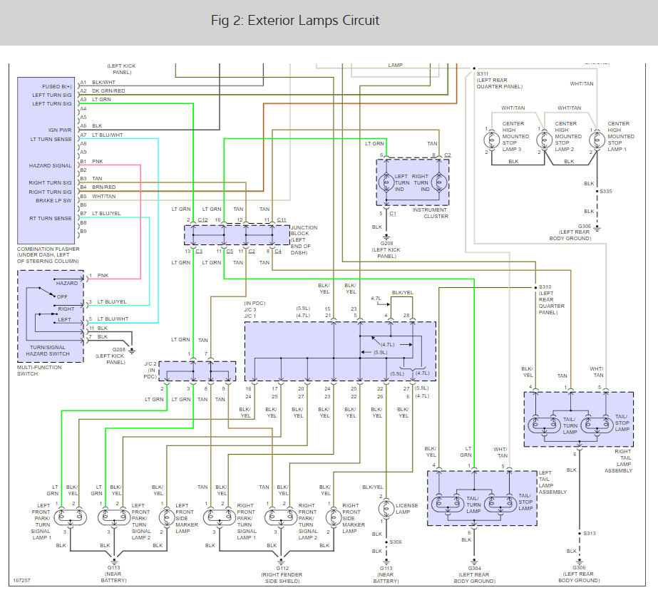

Running lights work, driver side (left) both front and rear turn and brake light not responding. Thoughts?
Oct 19, 2019 at 10:34 AM (Merged)
  • 54,350 POSTS

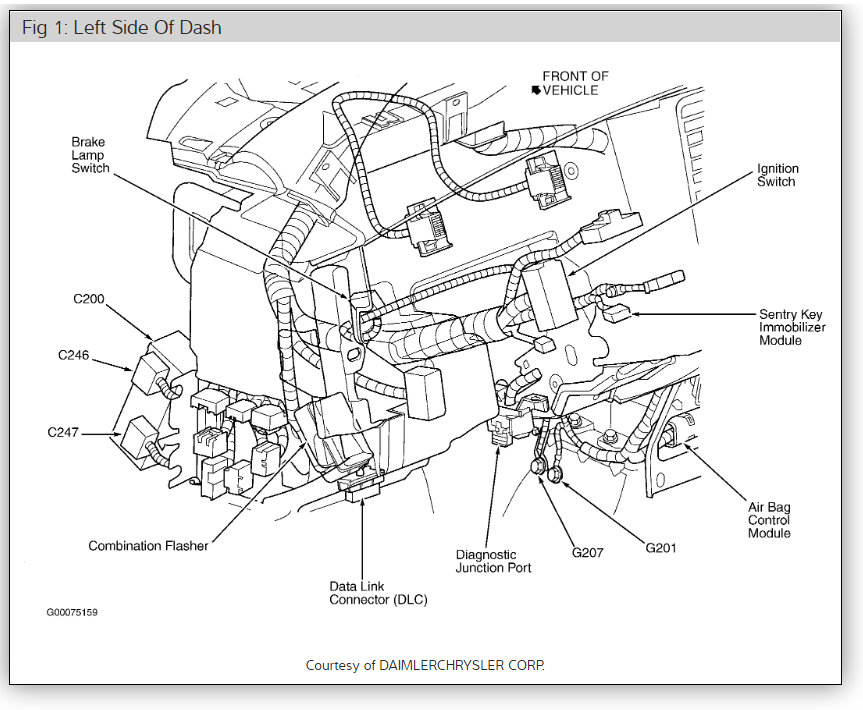

This is common when the combination hazard/turn signal flasher goes out here is the location. Check out the diagrams (below). Please let us know what happens.
VASDEN
Sorry I didn't get back to you sooner, short in the combo flasher. The wire harness image was a great help too.

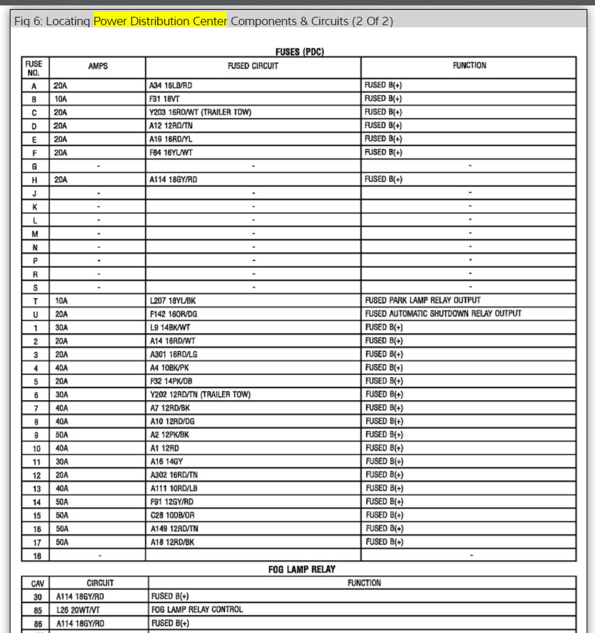

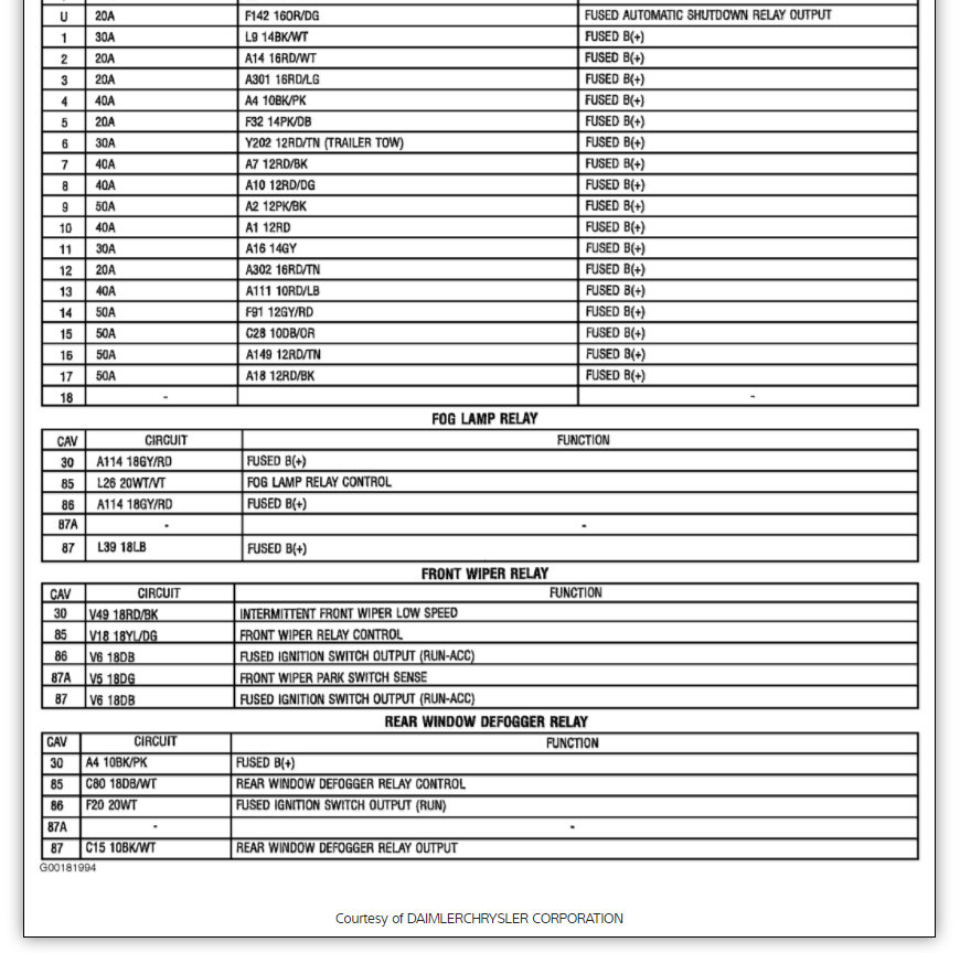

where is the brake light fuse on a 2002 dodge durango? nothing is labeled brake light
Oct 19, 2019 at 10:35 AM (Merged)
  • 54,350 POSTS
Here is a guide and some diagrams (below) that will help you find the fuse and relay. These guides will help you test and replace the #FL5 fuse and the system relay.

2001 Dodge Durango SLT, 2wd....no brake lights....bulbs, brake light switch and 30 amp fuse under hood all chek out good....help!

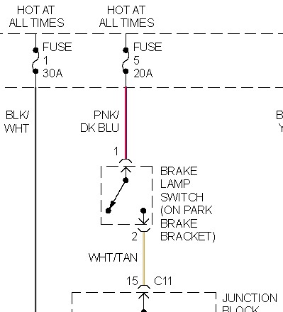

JDL
  • 16,098 POSTS
Did you use a voltage tester on circuits you checked? Does the highmount brake lite work? If none of brake lites work, check voltage at the brake switch.
In the diagram, the top wire is voltage to the brake switch, hot all the time. The bottom wire goes hot when the brake switch is activated.

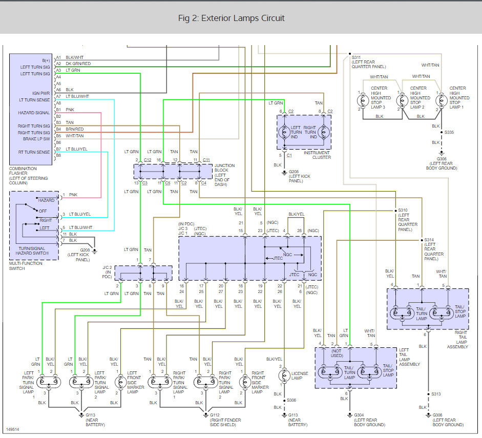

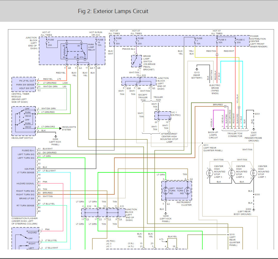

Top center brake light do they come on? If fuse no.5 20 is okay and pink and dark blue wire at the brake switch has power and the top lights come on. The white and tan wire for the bottom brake lights is open between splice 311 at left rear quarter panel and the bulb socket

You must be losing power somewhere it is a straight shot from the switch to the bulbs. Here is a guide to show you how to test for power and the brake light wiring diagram below. See if you are getting power at the switch. Also test through the combination flasher.

My left rear brake lights do not work. When the brake pedal is depressed the right light comes on but the left does night. When the head lights are on the rear lights come on both sides. The bulb was replaced but did not fix the problem. I even took the bulb from the left and put it in the right and vice versa and the left still did not come on but the right continued to come on so I know it's not the bulb.
Oct 19, 2019 at 10:36 AM (Merged)
  • 75,992 POSTS
Hi herbham, Welcome to 2carpros and TY for the donation
Inspect and test splice S311 at left rear quarter panel if connections is good there, the white and tan from this splice is open to the left brake bulb socket

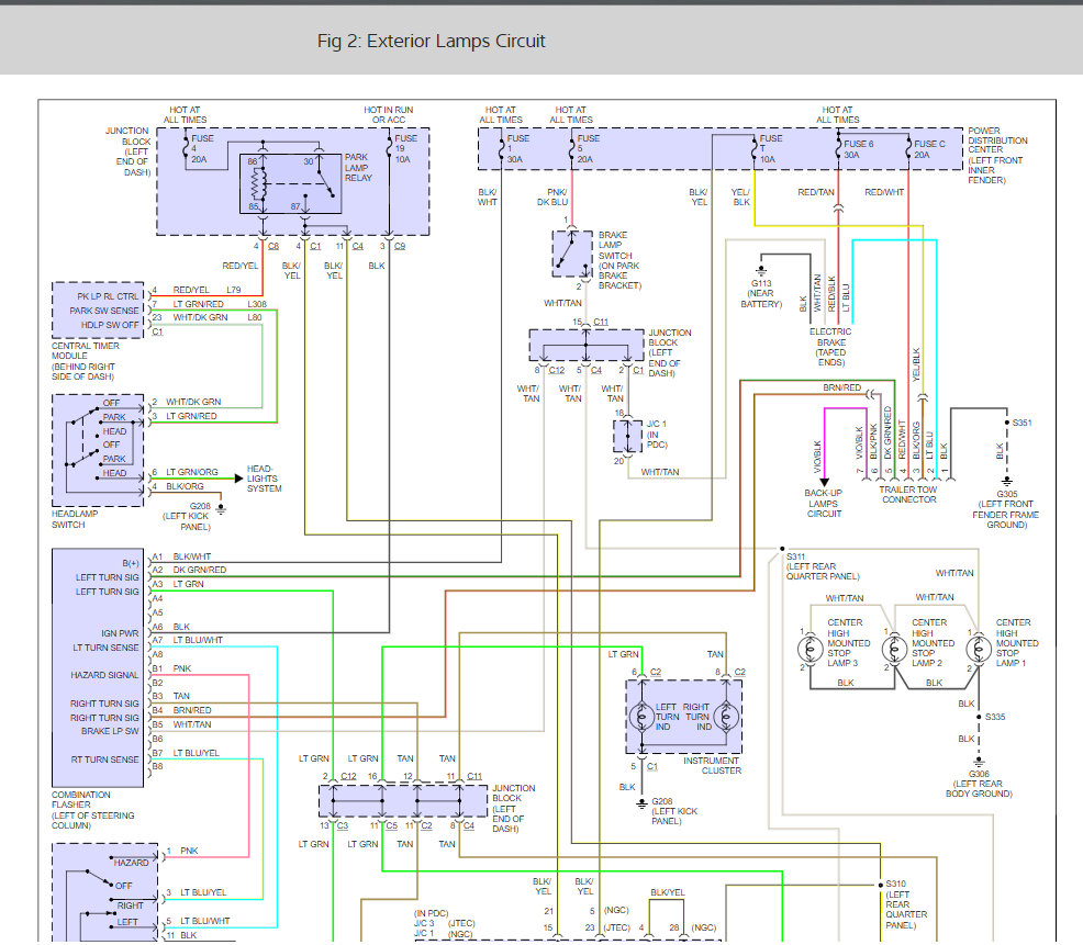

Brake lights fail. Tail lights work, hazards work, turn signals work, the brake lights are the only thing that won't.
Bulbs are good. Fuses are good. Replaced switch twice to rule out human error. What's next?
Oct 19, 2019 at 10:37 AM (Merged)
JDL
  • 16,098 POSTS
Does the high-mount brake lite work? If none of the brake lites work, check voltage to and from brake switch. Pink wire with dark blue tracer is voltage to the brake switch. That is a fused circuit. When the brake switch is activated, the white wire with tan tracer becomes hot and carries voltage to brake lamps. The brake switch should be activated by the brake pedal arm.
RFAULK1
The high-mount doesn't work either. My husband tested the voltage to the white wire today and stated that no power is getting to it. Also says there is continuity between port 1 and port 2. I'm not sure what any of that means.
Thank you for replying by the way.
JDL
  • 16,098 POSTS
What about the pink wire with dark blue tracer? If the white wire isn't hot with the brakes applied, check the pink wire with blue tracer for voltage. If one wire is hot and the other isn't suspect the brake switch.
