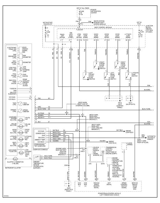

217000 km. After starting my van, spedometer stopped working, and my transmission is stuck in 2nd gear, my service light came on. (I read that this is a LIMP mode).
I took out the speed sensors, and on one with a magnet on the end were metal shards, so I cleaned that and hopping that this will solve the problem, but nothing happened. I tried to get a code and it shows code 23 (intake air temp. Sensor voltage low or high) and 55 (should be end of the codes), but as far as I know my engine doesn't have intake air temperature sensor. (3.0L V6 Crysler). I did a instrumentation diagnostic (test) and all gauges all working, the speedometer also. My engine oil is still red. Im still stuck in LIMP mode.
Help please.

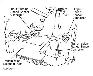

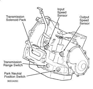

Hi Trans has two speed sensors input and output. see figure Faulty output will take out speedo and put trans in limp-in mode. Your van has OBDII go to an Auto Zone have codes read. then post will advise.
Hope this helps

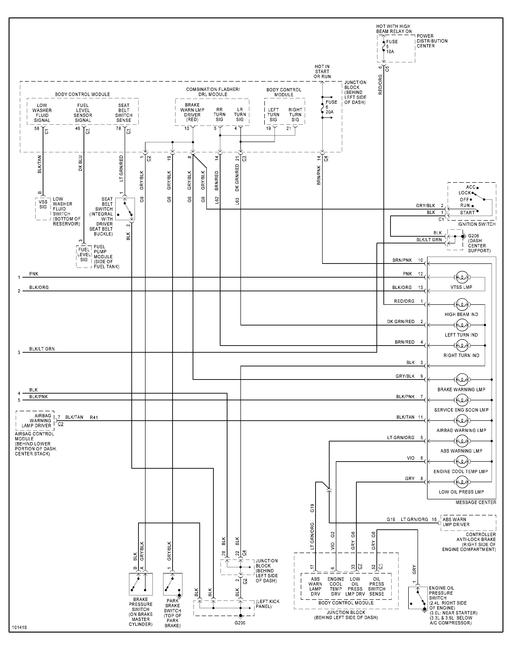

BMRFIXIT
  • 19,053 POSTS
Replace the two sensors
check wiring and ground wire

My 99 caravan with the 4 speed auto trans just had the speedo stop working and the trans won't shift out of low. I don't see any obvious line breaks or loose connections. What sensor might affect this and where would it be?
+1
Thursday, August 29th, 2019 AT 2:12 PM (Merged)
ZACKMAN
  • 4,202 POSTS
Replace your input and output speed sensors, located on top of the transmission. Both should cost you around $40.
+1
JPK1291
  • 7 POSTS
SOLVED
Replaced the output sensor ($28 OEM) and works fine now.
Thanks for help!

My Speedometer stopped working. How do I repair it without a costly garage bill
+1
BMRFIXIT
  • 19,053 POSTS
Suspect speed sensor
you have two
replace them both
Good luck
