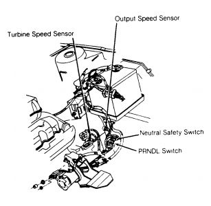

AFLEWEL1
Where are the "plug" and "neutral start switch" located that you're referring to? I want to get as much and as clear information as I can to go to my auto tech.
Feb 4, 2009 at 8:01 AM
2CARPRO JACK
  • CAR REPAIR CONTRIBUTOR
  • 11,533 POSTS
On the trans facing the front of the vehicle, the plug is where the electrical plug into it
https://images.2carpros.com/forum/automotive_pictures/1639_Graphic_1.jpg
Feb 4, 2009 at 8:17 AM
AFLEWEL1
Thanks. I'll give this a try.
