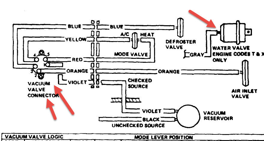

COLD AIR AFTER NEW HEATER CORE
EUGENE KERR
  • 1985 BUICK LESABRE
  • 5.0L
  • V8
  • RWD
  • 121,000 MILES
I REPLACE THE HEATER CORE AND NOW ALL I GET IS LUKE WARM AIR NOT ENOUGHT TO DEFORST MY WINDSHIELD. WHEN REMOVING THE ELECTRICAL CONNECTORS FROM THE RESISTOR ONE TONG BROKE OFF AND I HAD THAT FIXED BUT I STILL CAN NOT GET ANY HEAT.
Wednesday, October 21st, 2015 AT 6:57 AM
HMAC300
  • 48,601 POSTS
See if vacuum valve on engine is not getting vacuum if not you'll get no heat both heater hoses should be hot. Then check air intake valve and vacuum valve selector. Also check for vacuum leaks.
