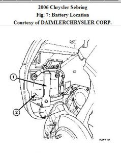

Where is the battery located?

The battery is located on the drivers side in front of wheel. To access you do not need to remove front wheel, just remove access panel.
