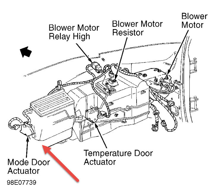

I only have air/heat coming out the defrost (some slightly through the floor) and I have already replaced the blend door actuator under the floor pedals. The problems still exists, so what could still be the problem?
Jul 8, 2019 at 3:24 PM (Merged)
HMAC300
  • CAR REPAIR CONTRIBUTOR
  • 48,601 POSTS
you need to check mode door actuator. try pulling fuse first for sixty seconds with key on it may reset and be okay otherwise see one in picture. blend door actuator is for temperature like heat to air conditioner.

That might be what I replaced (mode door), it was under the dash above the gas pedal. I replaced it and I see if moving when I change the controls from floor to defrost, but the blower still comes mainly through the defrost. The mode door controls where the air goes right?

no you probably took the wrong one apart the pic shows correct one it may be a broken door or shaft

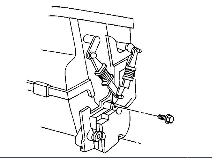

RACHELDART
Replacing it under dash driver side. It’s on and wires connected but the metal arm with a gromlet won’t stay inside the circle keeps coming out. I do see the gromlet is wore out. What do I do here?
Sep 24, 2020 at 10:35 AM (Merged)
Good afternoon,
Is this the door that you have? Can you post a picture of what you see? Check out the diagrams (Below). Please let us know if you need anything else to get the problem fixed.
