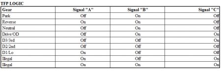

Shift vehicle in gears but does not move forward or backwards. Get OBDII code P1810, which is TFP valve position switch circuit. Is this a switch within the trans mission and does tranny have to be rebuild?
